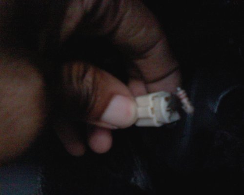

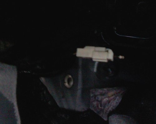

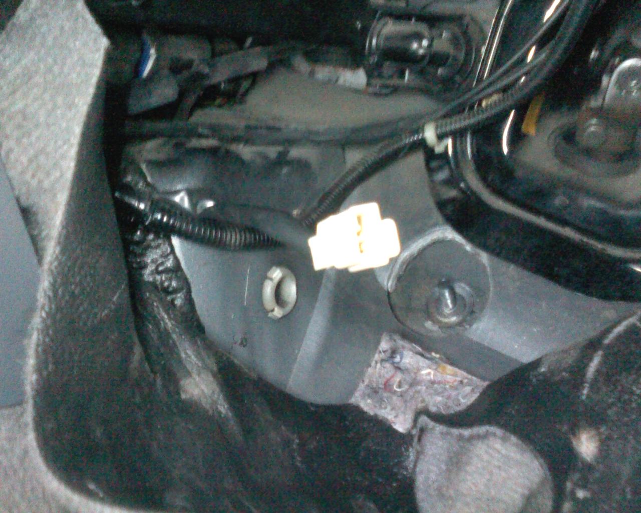

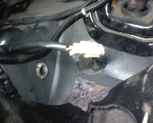

idlemind just got out below the car,there is no wires running below the car,which i found strange,looked like the previous owner removed the catalytic convertor and that is why the check light keeps coming on.
What i did find though was a small piece of rubber like a seal below the car,followed it back to inside the car rite where the console for your left foot on the ground is and found a 2 pin white connector not plugged onto anything.
from my assumption the idiot must have of ripped it out from below the car
Can you tell me if this second sensor is a 2pin?
Seeing you have much more experience than i do can u say how am i going about fixing this?do i get the sensor and try to somehow get it into the exhaust or is there a way of bridging the connection so the ecu thinks its working properly?
images are attached,any help would be greatly appreicated

bro i getting the same code is it p0425? i have a gdi also and i have the sensor right after the cat. the sensor u looking to buy is one with 4 wires, 2heater wires 1 ground and 1 signal. i been trying for months now to solve this problem. i changed the one in front no luck , i even disconnected the one that is underneath nothin, swapped it with a new one same thing. nice picts though was lookin to find out where that wire goes. u can buy the NTK brand its bout 350 but a good brand think denso makes them . u cant bridge a connection there becuase the signal wire is what sends a 0.00-0.9 volts . read up on o2 sensors ull understand,. i had on my cat and i got the error code and then i removed my cat and still get the error code. lemme know what u doing from here u can me pm if u want to know anything else.

I came across a check light and came up with a code po425 which was making my car run lean and i thought was a oxygen sensor,but because the previous owner removed the cat below the car and removed the sensor with it.i couldnt be 100% sure
well after extensive research and some help from raybic(a fellow tuner),i found out that the sensor i was searching for that was causing this code was a egt sensor/probe.
The egt sensor(exhaust gas temperature sensor)is a probe like sensor that goes into the catalyst below the car and monitors the temperature of the catalyst and throws a code if it detects overheating or a malfunctioning cat.
ok enuff explanation.This is the solution

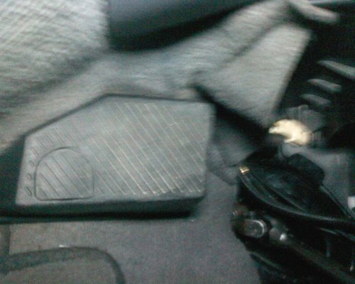

Remove foot rest on driver side,you need a 12" depth to do this

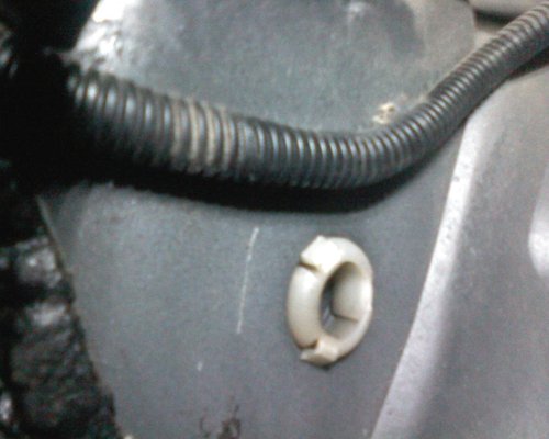

Remove carpet to find this(this is the hole which leads below the car to the cat)
There should be a two pin wire harness which should have a white connector onto it(this is what the egt sensor normally plugs into)

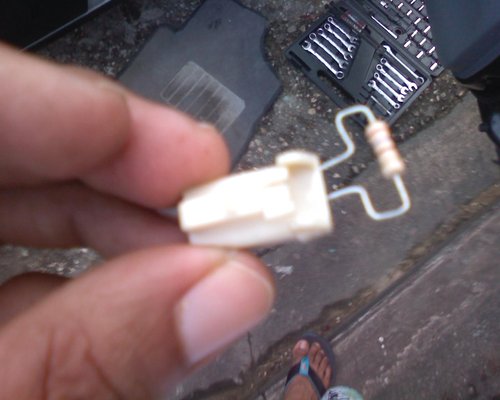

I used a 270 ohms resistor and plugged it into the connector(dis thing is 40cents for the lease by steves in san juan)you will need to disconnect the battery pole to clear the previous code
This is the connector with the resistor in
Once thats done,you mite want to tape it up to protect it from the elements
reverse the process and attach the battery pole,start the car and taaa ddaaa,no more freaking engine check light
This has been the second week and the only amber lights im seeing are traffic lights.
I swear this works
