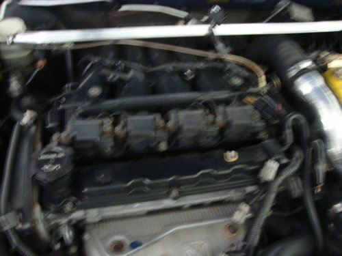

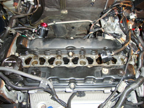

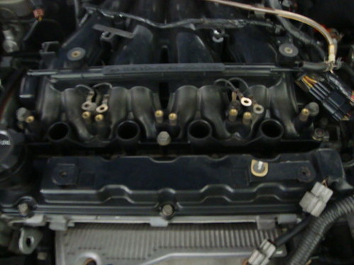

okay there is the intake manifold with coilpacks on top and head studs holding down the intake.
remove the coilpacks have 2 {10} bolts on each coilpack. after removal of the the coilparks there are 7 {12} bolts, 4 on top and 3 below where the coilpacks were. remove these to free the intake on the engine block, rememeber where the bolt comes from becuase as u can see there are 4 groundin wires on 2 of the bolts for the coilpack

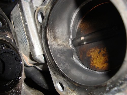

now to the throttle body , there are 4 {12} bolts, before even reaching this u have to remove the intake hose on the throttle body and also the battery for a reason...
when u finish this u should see the throttle body bolts. remove them but be careful. there is a gasket between the intake manifold and throttle body so when u unscrew this will slip out .
so i removed the these bolts and thought the intake would come off but there are sensors to which i dont know to much about to remove.
on the brake booster side of the engine, there is a vacuum line that has to be removed,
also the PCV valve on top the manifold on the left has to be removed. on my engine it had 2 jacks to remove running over the manifold towards the alternator area. removed them
on the throttle body side now, there are 2 jacks directly on top the throttle body that is attached by clips on the manifold, these have to be removed. there is also a vacuum hose on the the throttle body facing the firewall , remove that.
ok all the sensors and hoses were removed.

the intake manifold popped out.

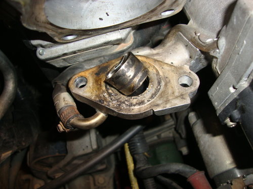

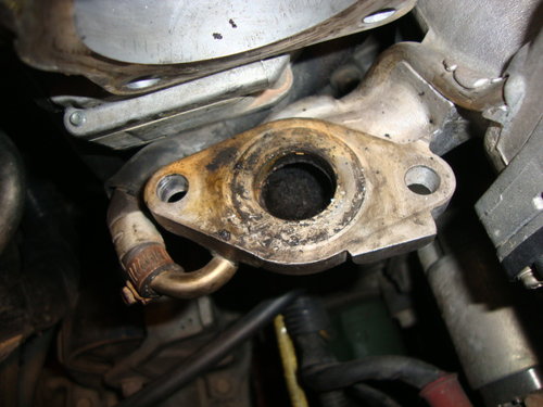

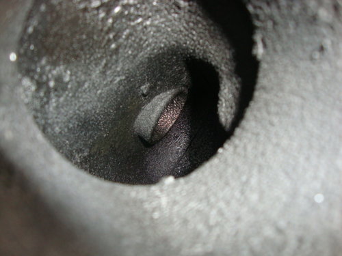

as rollingstock and xtech said . FLICKING CARBON BUILD UP LIKE WOW.
EGR VALVE

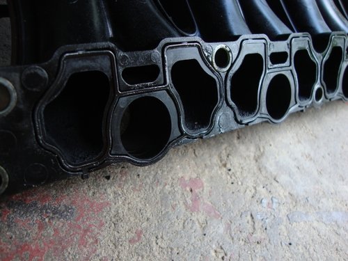

THIS THE INTAKE MANIFOLD THAT RESTS ON THE BLOCK , AS U CAN SEE THERE ARE LITTLE RUBBER GASKETS ON THEM , REMOVE THEM BEFORE WASHING THE INTAKE DONT WANT TO BURST THEM.
INSIDE THE INTAKE

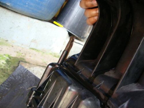

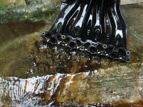

PICS OF THE INTAKE
WASHING THE INTAKE.
PURPLE BLASTER, PITCH OIL , SOAP, CARB SPRAY HAD TO WASH THIS THING LIKE 6 TIMES...
MALTA!!!!!
HAD TO USE A SCREW DRIVER TO SCRAP OFF CRUD, IN THE ENTIRE MANIFOLD. ITS LIKE CRUST

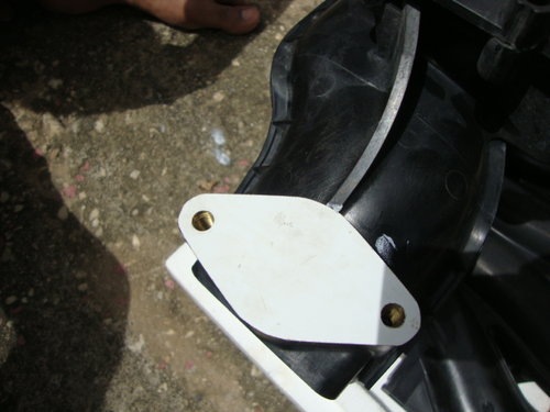

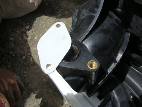

I looked at the many post here and some say its better to block off the valve to prevent the crud and TRUST me after cleaning the manifold u dont want to have to do that again..
on the egr valve there is a shim piece of metal that goes to lock tight back into the manifold. i removed it so i can place a plate on the valve to close off the valve and hence no crud!!!!

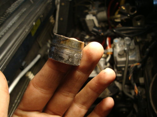

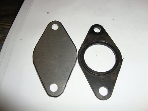

had to make a plate to block the valve , used an old piece of guttering.. didnt turn out to bad,
okay after the intake manifold was dried. make sure and DON T FORGET THE INTAKE SMALL GASKETS....!!!
remember the 2 gaskets, one for the throttle body and one for the egr valve. fellow tuner gave me a tip to put some mega grey silicone to hold it place when applying back the manifold .

Rolling stockyou are incorrect, raybic and myself went tru this earlier last yr.Zeroone you can do one of two things
1.put a resistor for ecu to think egt sensor is there
2.put back egt sensor on the straight pipe when you remove cat
Check this post.........viewtopic.php?f=33&t=420913
Re: DIY 4g93T GDI INTAKE MANIFOLD REMOVAL AND CLEAN
Postby rollingstock » May 16th, 2013, 8:58 am
^ Read about the resistor mod on other forums.
Personally i don't see the sense bypassing the cat unless it's a problem, the resistor just fools teh ecu. Whatever minute gain in power by removing teh cat is negligible.
ZeroOne
Posts: 2253
Postby ZeroOne » May 16th, 2013, 1:35 pm
excellent work around there nissan4life.
I like to have multiple options.
Im not gonna interfere with the cat though, like stock said the gain would be marginal.
Just wanted to make sure that blanking the egr would not adversely affect the cat converter and exhaust manifold.
