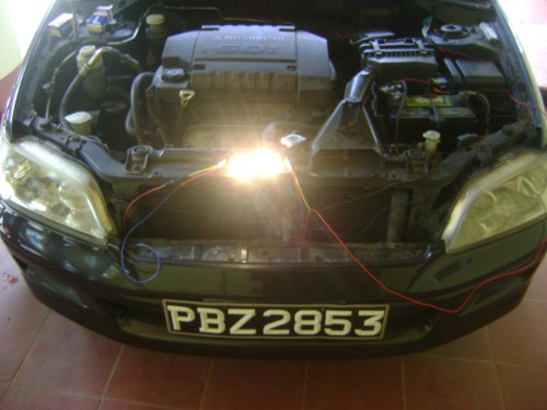

I started by wiring my relay..You are going to have 5 wires on the harness for the relay
Thick red wire which leads to # 30 on relay this goes to your battery
Thick white wire which leads to # 86 on relay this goes to switch and is your hot wire
White wire which leads to # 87 on the relay this wire is to be extended and leads to +ve wire on your fogs(-ve wire on fogs goes to ground on car)
Black wire which should lead back to # 85 on the relay and should be attached to a ground
The extra blue wire should be left alone because we dont need it for this application. Heres a pic,wires alil messie but i was just testing wiring before securing evrything.
