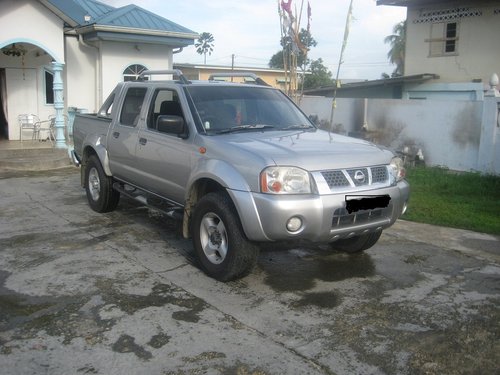

Postby kevinsonny » October 14th, 2011, 8:00 pm
hey tuners , just wanna get some info on my frontier, the van is an 04 model , doing approx 256xxx and well after time , to me the front of the van looks lower than when i first got it, so i was thinking if this is a normal thing with these vans? or if my torsions need to be cranked ? ill take some pictures tomorrow of the van so you guys might have a better idea ,

Postby kevinsonny » November 29th, 2011, 7:46 pm
update: soo i cranked them myself and got the wheels alligned back , the truck looks great now. ill post a pic in a while before and after.
after!!!!!!!!
before

lighthammer
Posts: 4519
Re: height on 4x4 d22 frontier.
Postby lighthammer » November 29th, 2011, 11:13 pm
looks great man, good job!
How's the ride now?
kevinsonny
Posts: 112
Joined: July 10th, 2008, 11:31 pm
Postby kevinsonny » November 29th, 2011, 11:27 pm
the ride is a little less bouncier lolz !!! it rides a whole lot better!!!!!
