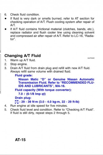

Jus spoke to a guy and he told me i cannot use NS1 in a non cvt application. Can anyone shed some light?
Also, taken from a qg manyal with non cvt transmission:

Postby skylinechild » January 22nd, 2014, 4:35 pm
use any transmission oil that meets or Exceeds the nissan matic D specification.- as your manual said. i would recommend Gulf synthetic multi vehicle ATF.
it actually meets the following specifications from Nissan
"Nissan Matic-D ,Nissan Matic-J, Nissan Matic K
"APPLICATIONS:GULF PRIDE®SYNTHETIC ATF is suitable for use where the following
specifications are required:
•Allison
•MERCON
•ATF +4
•MERCON V
•GM DEXRONIII (including II)
• Toyota T-III and Toyota T-IV
•Honda
•Others
•JASO 1A"
read more about it here >> http://nu-tierbrands.com/ckfinder/userf ... %20ATF.pdf
you CANNOT use NS1 or NS2 as these were designed for CVT transmissions.
eitech
Posts: 3626
Re: WTK: Nissan Almera CVTC E-Throttle
Postby eitech » January 22nd, 2014, 4:55 pm
Thank u very much for dat info

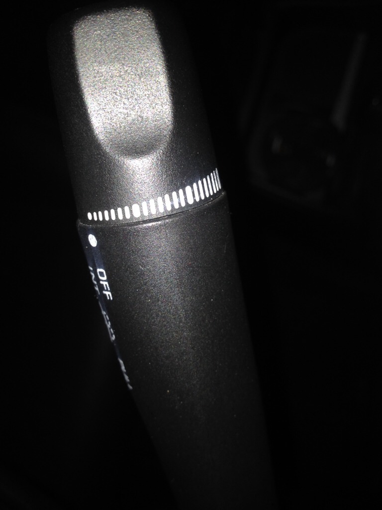

3 questions:
I saw "cruise" and "set" on the instrument panel. Does that work?
Can you tell me what's that feature on the wiper lever? See pic. Thanks.
