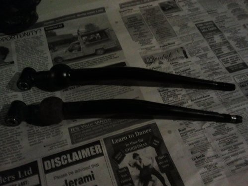

Swaped my damaged shifter with this new OEM unit.

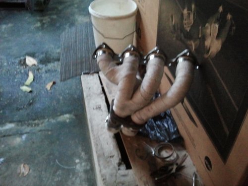

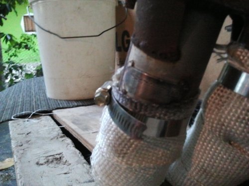

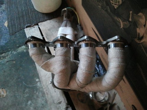

Wraped... That got my had iching all day today.

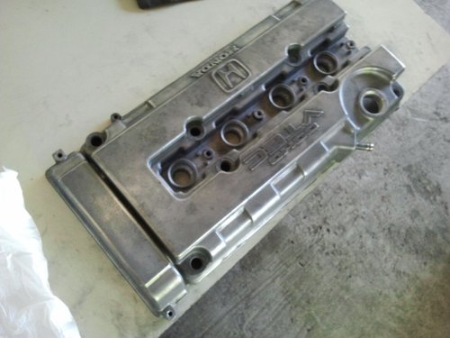

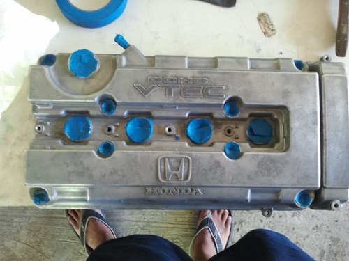

Prime and re-sand today will paint in the morning before work.
Taped up
Striped and ready for paint after 2 afternoons of cleaning and sanding.

Re: Painting my valve cover and wraping my spoon header
Postby CD4Accord » January 29th, 2013, 11:14 pm
What wrap did you use? I recently did a header in the new DEI "Lava" Header wrap.. Aka dry wrap..
It looks great and was pretty easy to do.. The ends fray a little if you are not careful but overall was a good experience...
JDM_GUY
Posts: 1556
Postby JDM_GUY » January 30th, 2013, 9:42 am
^^ same thing...
CD4Accord
Posts: 1609
Joined: December 15th, 2009, 12:20 am
Postby CD4Accord » January 30th, 2013, 8:08 pm
hMMM, looks a bit different to mine but it could be the pic..
Anyway, how many feet you end up using? To wrap that one accord header i used almost 45 feet yes..
I did wrap the header all the way down to the collector though
JDM_GUY
Posts: 1556
Postby JDM_GUY » January 30th, 2013, 9:50 pm
I used about 55 feet.

How'd you get the lettering on the VC clean ? Hand sanded or dremel ?
JDM_GUY
Posts: 1556
Postby JDM_GUY » February 1st, 2013, 10:43 am
Razor blade and some sanding with a flat block. Time is also a factor.
r3iXmann
Posts: 4299
Location: Straya, m8.
Postby r3iXmann » February 1st, 2013, 12:30 pm
Next time, just put some grease on the lettering with q tips before you paint..comes off much easier.

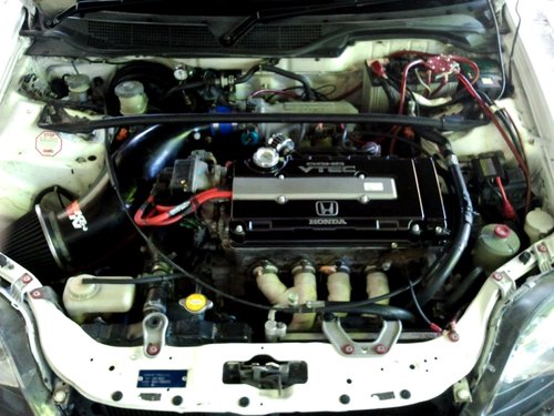

Here is a shot of the bay this morning.. I was going to paint it flat black but I wasn't getting the heat-resistant paint. They only had gloss. Next time I will order a flat black online.
Engine shot this morning before work!

you can get both flat and wrinkle paint at FT Farfan

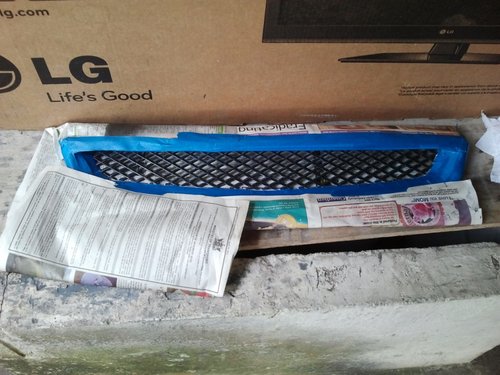

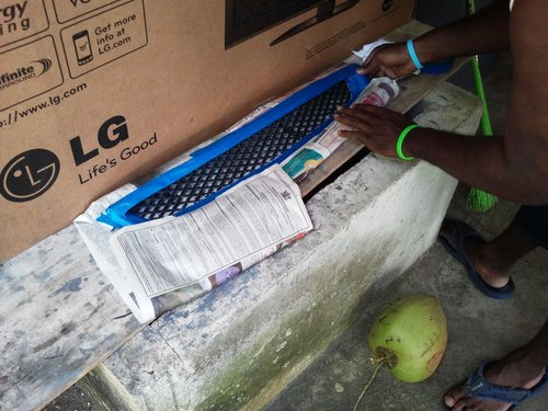

Postby JDM_GUY » February 2nd, 2013, 9:18 pm
Painting the grill
Ready
Painting the grill
