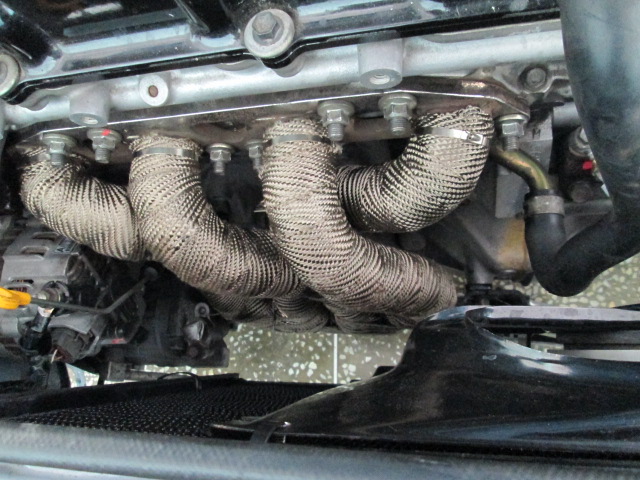

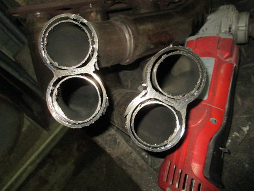

Postby d_sunnyboi » February 13th, 2013, 8:02 pm
was...was decided on modifying the oem extractors that came with the 20v but when i started cutting i realized its not what it appears to be...as you can see its a pipe inside of a pipe..so i got an extractor type manifold from the 1st generation ve and used that..which is stainless but will be wrapped in titanium heat wrap.

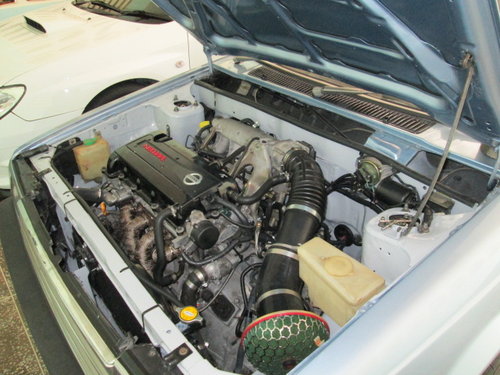

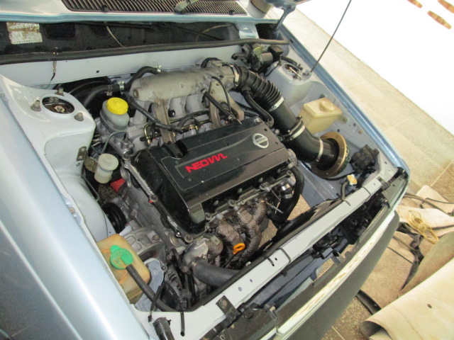

Postby d_sunnyboi » February 20th, 2013, 4:37 pm
updated pics of the engine bay... changed the gear oil from the gl5 amsoil to redline mt85 gl4...works great smooth shifting through all the gears..but the c33 coilovers are way to stiff even on the softest setting so will be one the hunt for something more suitable.
