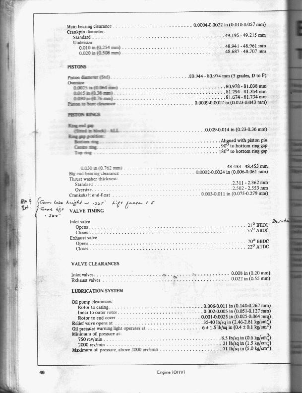

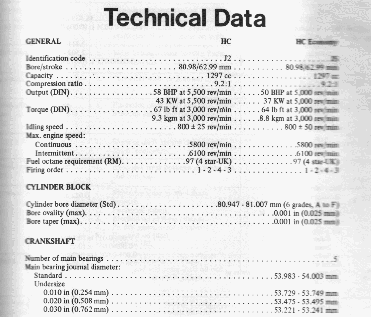

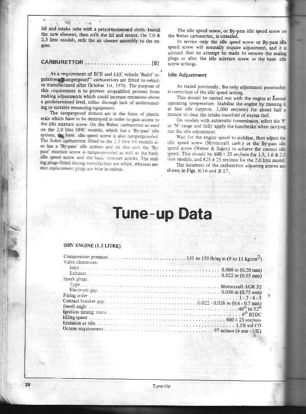

Precious Roy
Posts: 119
Joined: August 7th, 2005, 10:56 pm
Location: San Fernando, Trinidad
Re: Ford engine
Postby Precious Roy » May 29th, 2010, 11:55 pm
Oh man I was offline for a while and never got back to this thread. I was looking through some of my old posts and saw the request for specs on the 1300.
This is all I have on the 1300OHV, sorry Maximus, I know its about a year too late but I hope its still of some use.
