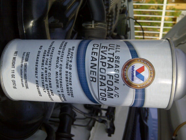

the products: (sorry, photo refused to tilt)

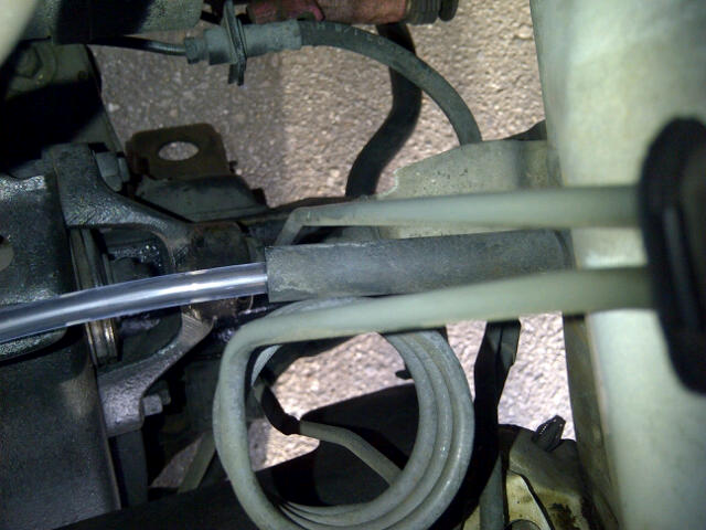

Where it begins. cannister #1 comes with a hose extension. one end affixes to the can, the other goes into the drain line of the evaporator housing. i pushed it in as much as i could.

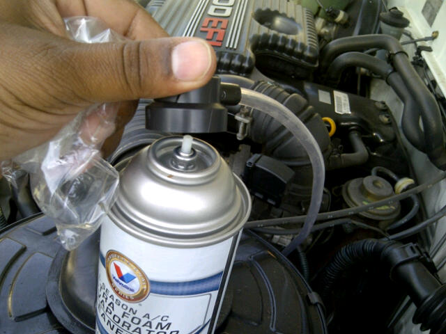

hose being attached to the top of the can

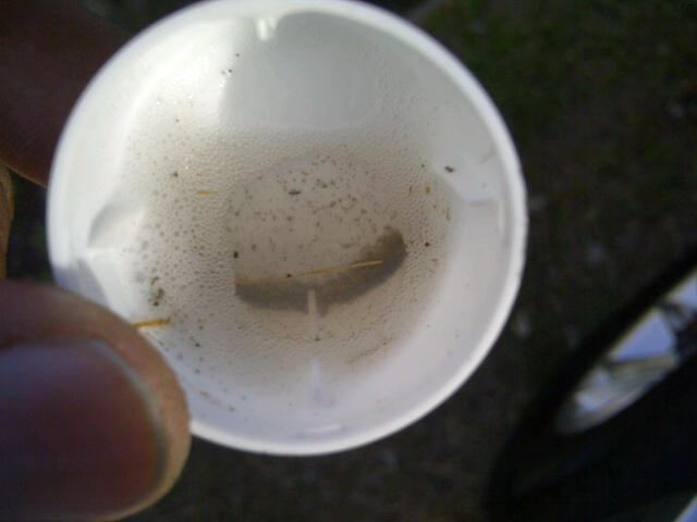

the result!! i didnt have a drip pan, so icollected just a sample in the cannister cover. damn! is this what i've been breathing in?
