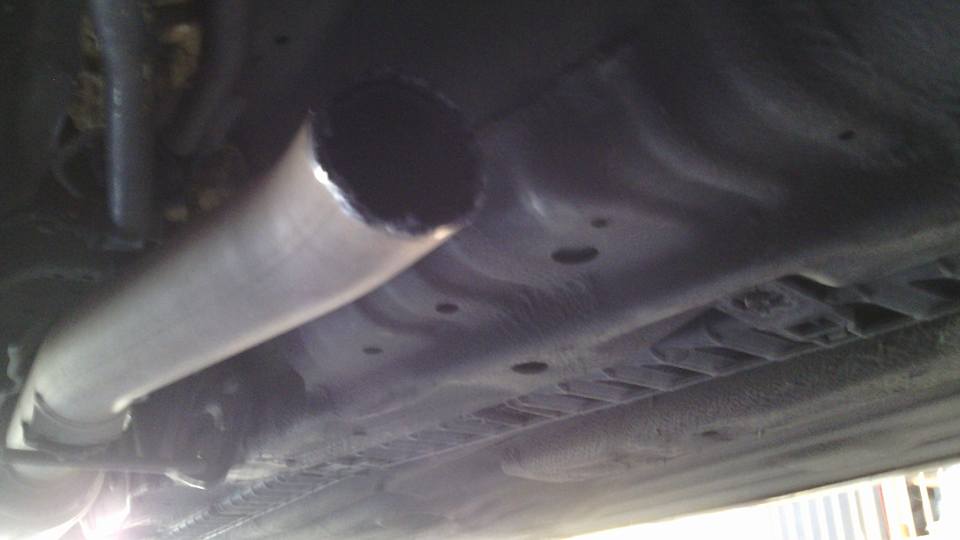

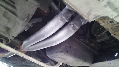

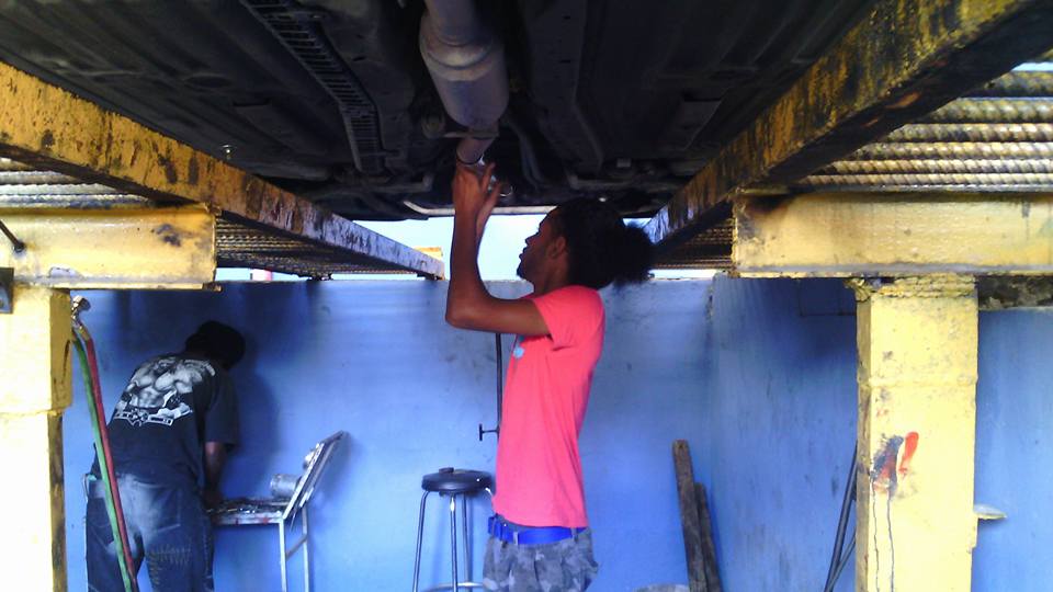

So after 3 years of driving around with a bottle neck in the exhaust i decided as i was on vacation i would get it repaired. Upon getting it sorted we discovered I have been driving around with a broken header for 1 year.
Where the header collector meet with the exhaust was only 1.3"
The exhaust size on this side is 2.25"
The used flange i got that now is 2.25"
Exhust kid doing his work. This man knows his stuff (Golden star)
Also got the bends out the down pipe, painted it when we took off the heat wrap.
Unwrapped the headers also, I think that contributed to the crack because of the heat buildup. Original Spoon sports.

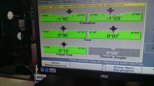

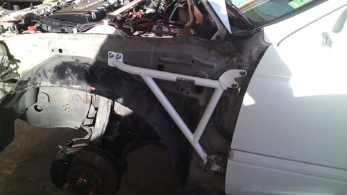

Got that alignment sorted out yesterday after replacing the 2 front shocks and installing the new front fender braces. Car feels much more pointed, I love how making little changes on the car feels. Ken Brown (KP) knows his stuff when it comes to alignment, I would recommend him to anyone.
Rear before:
After adjustment:
Front before:
After adjustment:
The new fender brace fitted:

I decided to get the fender brace to reduce the flex between struts and the A-pillar area. By comparing the few generations of the CIVIC, you can see that the A-Pillar moves closer to over the wheels over the years. I have drawn a straight line down the A-pillar to illustrate the difference. So guess which civic has the least flex.

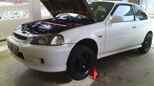

Postby JDM_GUY » January 7th, 2016, 12:07 pm

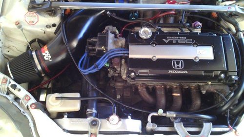

Upgraded my cooling system as I was off for the Christmas. This should help better cool the car at track days.
OEM hoses and coolant
CX racing 2 core rad

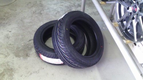

Also got some new street rubber, 195/55/15 nankang ns2

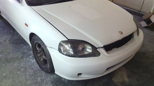

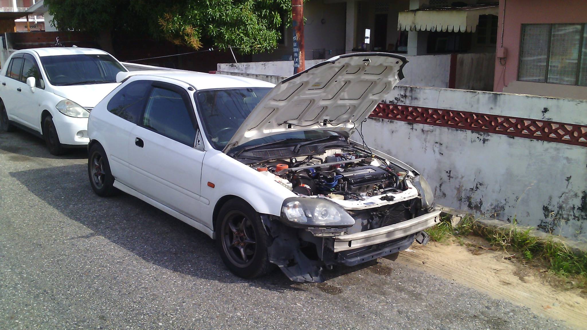

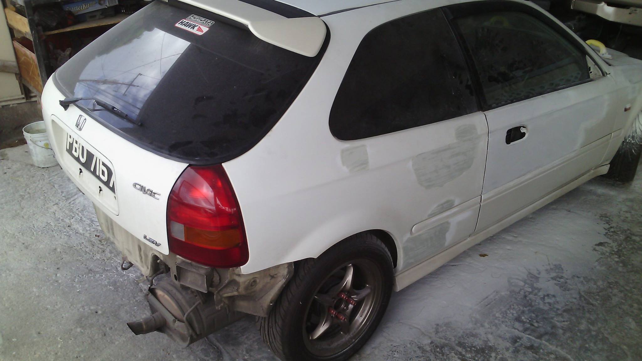

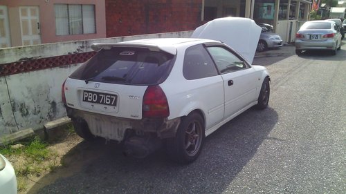

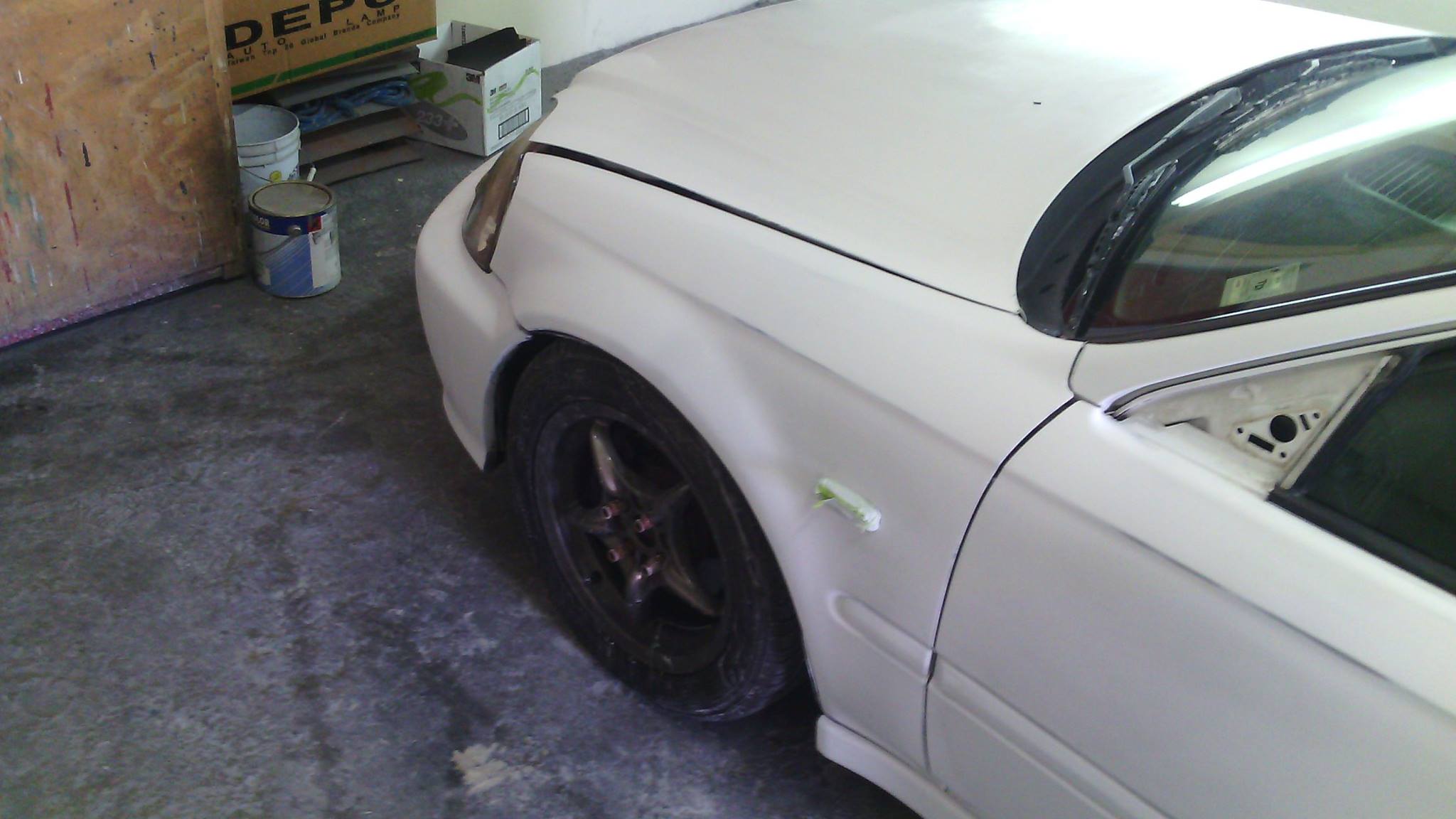

Body job has started, owning the car for the past 5 years I have always wanted to do this but never had the time nor money. Everything line up just to rub, seal, prime, rub, prime again then paint.
Will update as the progress take place.
Front bumper removed to repair.
Front of the car.
Rear bumper removed to repair.

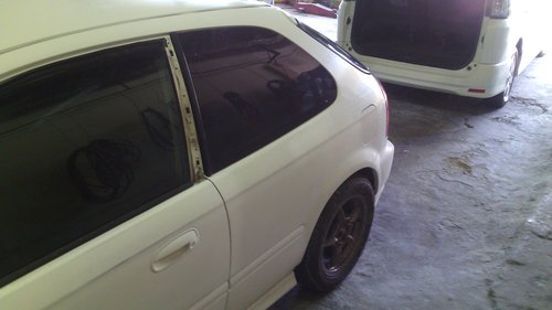

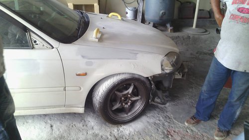

New front bumper lip arrived today. Car is being sand and prep for primer.
JDM_GUY
Posts: 1556
Re: JDM Guy's Car Blog (update Paint time)

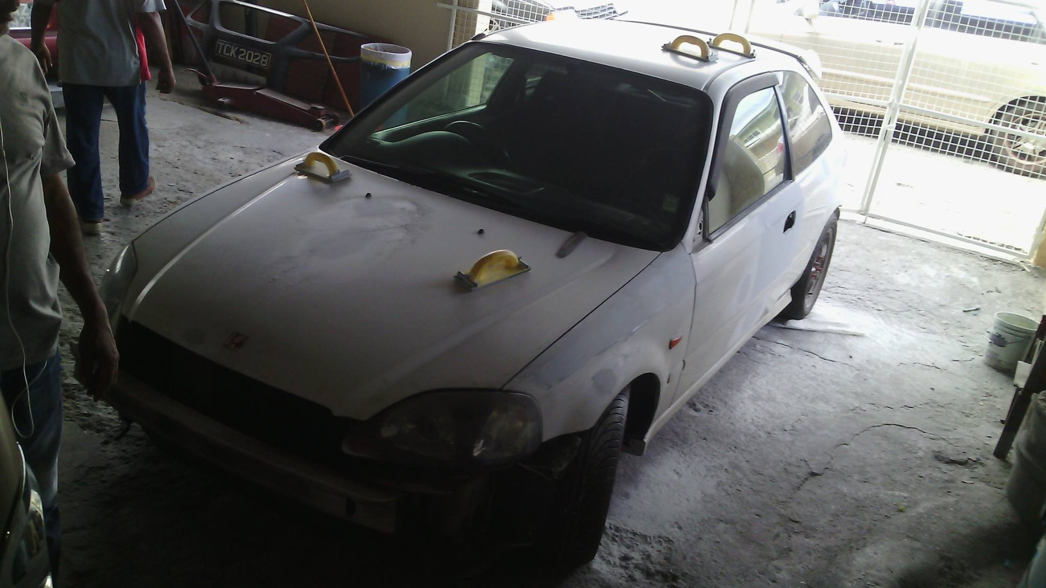

Postby JDM_GUY » February 23rd, 2016, 12:01 pm
The is now in the paint room, it was primed and re-sand to make for a perfect finish.
Rear of the civic with the bumper line up
