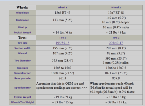

Put the rim sizes and tire sizes in a calculator below are the results
seeing that result state that it wouldn't make a difference in the cars performance with the rims weighing only 14lbs each

Update:
Since then i have put back on 15" rims and 195.45.15 tires and the car goes into fourth in d4 and passes 160kph. the car now revs and accel much faster.
