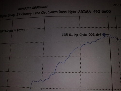

yo jdm guy this is my bro b16a dyno chart,we bought this engine an got some ups an downs with it.e.g bogging down.we checked ah few of the honda mechanics,didnt get through buh never the less we dyno with the problems. by the way stock b16a it came out from ah eg6,the only mod was cone filter ($120),so here is the dyno chart, 135.01 hp 95.73 tq

a stock engine makes 135 and jdm guy puts in all that fanciness and makes 139?
did u check the basics like i told you to when u contacted me?
hardeness again :roll:
check your ignition and fuel system

Weak B16 is weak.
The more mods you put on it, the more suspects for the problem you're having.
Stop adding stuff. Fix your engine first.
I didn't read this thread in a while, but did you put in ITR cams with your B16 springs and retainers so they undergoing more lift and duration than the people make them for?
And why didn't you wait until you could afford a better flow IM before you put on the better flow TB?
Take your time meng. Haste makes waste. You'll get there, you already have a nice shopping list so far.

well we changed the engine about two months,wasnt gettin through with d problems,i just post d dyno chart to compare to yours.was checkin progress with mods on ah b16, problems we had was engine had dead spot/flat spot or power loss.we checked some of the mechanics listed on d forum they good an everything buh not for that problem.buh no stress changed engine,good to go now. still learning.thanks...
Sky
Posts: 4121
Location: BRRAAAPP!!!
Re: ITR 62MM TB Dynoed 19/08/2011 PG3
Postby Sky » September 1st, 2011, 9:40 pm
He said the main ones. Ignition and fuel system.
They can both be buggy from the ecu. Check through the wiring.
Do you hear ANY detonation at all?
What about back firing when changing gears or coasting?
How does the spark plugs look? What kind do you use?
How does your old oil look? What type do you use?
Sometimes modifying causes issues, but you can't start modding when you have issues. That's like a handicap against your favour. Modding to get stock power. Let reix and dragon add anything I missed.

well i dont have any problems now cuz i changed engine, an i dont have any mods except for ah cone filter. based on my old engine- 1- no detonation 2-backfiring yes 3-plugs black around d edges an d center brownish colour 4-started ngk heat range 6 an mechanic changed to champion platinum series 5-oil look dark colour type mobil 1 15-50 was burnin switched to shell 20-50 still burnin buh less.i just listed these things buh there is no use cuz this is past tense,it was jus to give u an idea what happened. as i said i was just comparing jdm guy dyno chart to we got with my bro b16 since it was givin trouble an came with 135hp.thats all.thanks
