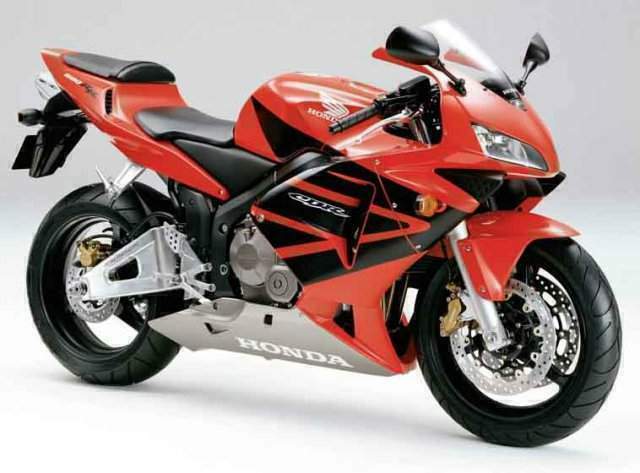

But after all of this I think I want to get into a Honda 600cc bike. Thats the ultimate.

but the bike is the best direction for speed but 600 blah .....1300 FTW

I just getting fedup of the car thing. Just get a bike and speed is obvious.
