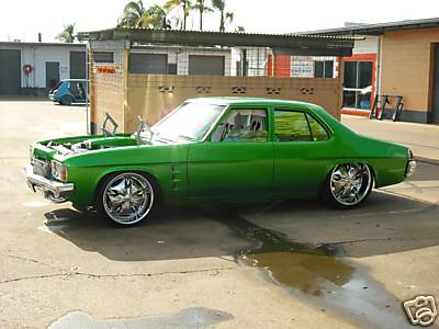

The car presently has the original Diff. It manages the power well enough so far but I will upgrade in the future. The cambering of the rear wheels may not be necessary and is not really my main concern. What I am interested in is the front end. It definitely needs cambering and the alignment is a bit off.
It is presently running on 15" Rims with 225 R60 tyres (real muscle look). I intend to go with larger rim size and lower profiles but with the cambering off this would be a catastrophy, it is also presently dangerous with the existing power.
Some amateur alignment men said that the cambering of this type of vehicle is a bit different to that of the average japanese cars.
Although everyday I see another ole school car reborn, modified end to end, I still haven't met anybody up to the task of at least a proper camber and alignment.
This picture below is my Intention...
Thanks for all suggestions and advice...
