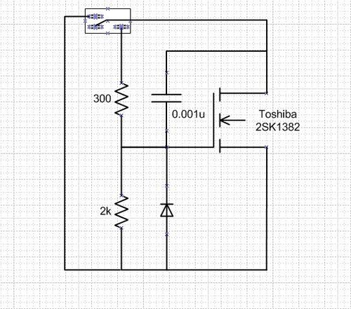

Need to find the Blower Fan Speed Module MR460293 as well as re-wire the connection, looks like the wires are burnt out.
I opened up an old module I had, electronics looked simple enough was just a MOSFET transistor attached to a large heatsink (grey portion) and some basic control circuitry.

Postby squinty_eye » June 1st, 2013, 7:27 pm
Fine wire is a control wire to determine how hard to drive the MOSFET transistor where the 300 ohm resistor is located. the heatsink is primarily used to cool the MOSFET transistor since it will be handling a lot of current and acts as the load resistor in series with the A/C fan blower.
