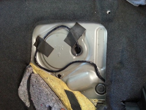

1. Removed back seat......4 - 14 bolts.
2. Locate gas tank entry point.
3. Turn and release 3 screws on cover.
4. Disconnect electrical and return fuel line from cover.
5. Turn counter clockwise and remove screw cover.

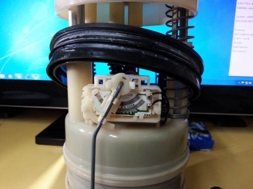

it turned out it wasn't stiction, but the metal contacts were very dirty. I didn't take a picture of it before i started to clean it...but it was so dirty you couldn't make out the metal terminals in the middle at all....so.....armed with a paint brush...a pencil eraser...and a surgical knife....i went to work....took about 5-7 minutes and everything was cleaned. Mounted everything back up....put it back into to the car. (note: screw cover was harder to go back in...so used some wd-40)
Guage works!!! before it was reading 1/4 tank....now its reading 1/2 tank.......
So its just to go to the gas station and fill up to see if it really solved everything..will keep you posted.
clean!
dirty
all cleaned!!
dirty metal contacts....already started to clean it
fuel pump assembly
disconnect stuff and remove screw cover
removed cover
entry point

some more pictures or rod and float assembly
full reassembled
without black clip
