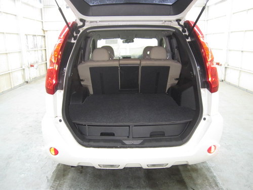

If you remove the drawers and the little piece on top will the trunk be flat? and does anyone know how come on most vans they only have one draw on the right side??
DVSTT
Posts: 6759
Re: THE T31 Nissan Xtrail...
Postby DVSTT » July 30th, 2015, 12:54 pm
Agent_47 wrote:If you remove the drawers and the little piece on top will the trunk be flat? and does anyone know how come on most vans they only have one draw on the right side??
It has one draw and the other is a cavity that extends straight to the end of the trunk. I think all of them cone like this from Nissan, design decision I guess.

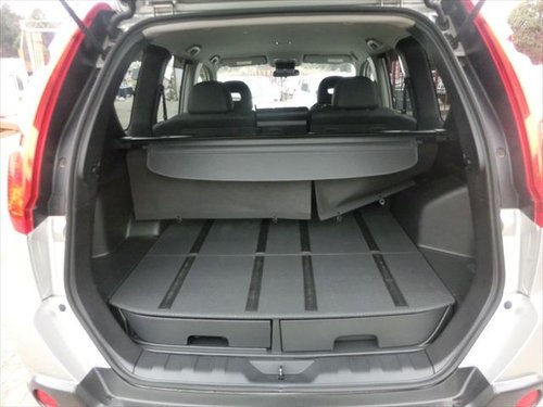

Ha!! 2 Drawers boy !
Both vehicles are here in T&T.
