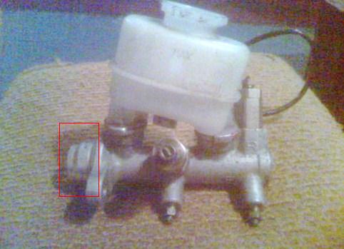

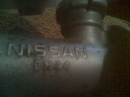

bought a rear disk pulsar setup for my b14 but didn't got the calipers in which i used the primera caliper an it worked.Now i know you have to change the master cylinder in which my car is non-abs an has 4 lines that was really hard to find.I got a bigger one which is a bm44 (15/16 bore) an has 4 lines also.Checked my stock master cylinder which has bm38 (7/8bore)
now before changing the set up just want to know what vehicle the bm44 came from cause not finding info on net an if from a 4 disk setup instead of changing the master cylinder can i switch the porting valves from the bm44 on to my bm38 for the mean while an also if i should change the booster cause the front has ad22vf need some advice before i start....
pics of the bm44 master cylinder
