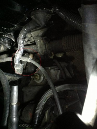

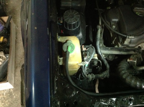

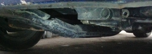

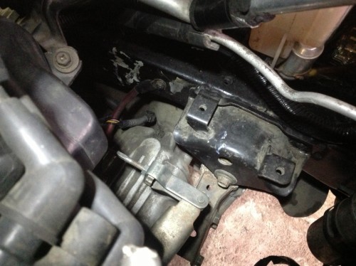

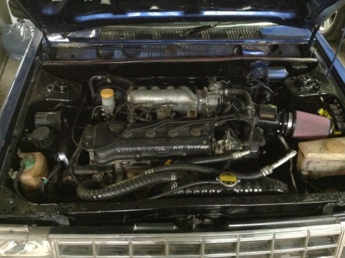

turboconch2
Posts: 239
Joined: April 14th, 2009, 12:19 pm
Re: *OFFICIAL NISSAN B11 CLUB*
Postby turboconch2 » April 27th, 2013, 3:11 pm
black start wrote:now back to my question....
Can anyone of of you do a detailed post of how to install a ga series motor in a b11?
Sorry so late bro. I inherited my car from my bro who got it from my dad, the ga15 b13 engine was installed in the car in the early 2000s so the engine was not lined up properly but used to run like a beast still. Only recently I got it lined up much better.
Ok so watching the engine from the front of the car...
The ga mount is used on the left side of the engine bolted in the original b11 spot, (the side with the belts)
For the gearbox mount I went to a guy in lachoos road penal, who told me to get the part that goes under battery from the b14. He took out he sunny bracket from under the battery and welded a nut inside the chassis and welded the part under the battery. This fits the ga gearbox mount that bolted to the gearbox.
For the back engine mount he told me to buy a cross member and get some high tensile bolts. The cross member was cut the welded back and bolted from the back to the front chassis underneath the front of the car. The mount used on the back was a ga mount.
There is no dog bone in the front though but i see no problem so far With the three mounts.
The driver side b11 axle work back but the left side was cut and welded. See if this can be avoided as if it is not done properly you may get some probs.
The rods for the gear levers were cut and welded, no problem with that also
As for wiring I have the entire ga15 de manual if you want, I did my own wiring when I put a ga16 recently, the only thing though I went by the electrician to put in a diag port cuz those things are getting scarce now.he had one plus scanned I for me.
I will try to post some pics soon so you can better understand what I am saying. Hope this helps

turboconch2
Posts: 239
Postby turboconch2 » April 28th, 2013, 2:15 pm
The car got in accident last year so its kinda dirty, awaiting the straightener :drinking:
here are the pics below
top engine mount
gearbox mount
back mount
cross member
