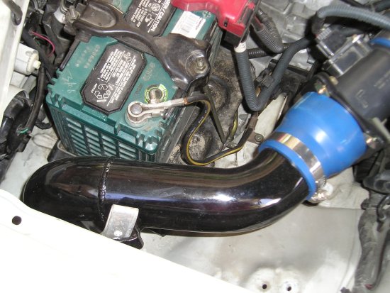

This is the Intake with the MAF adapter

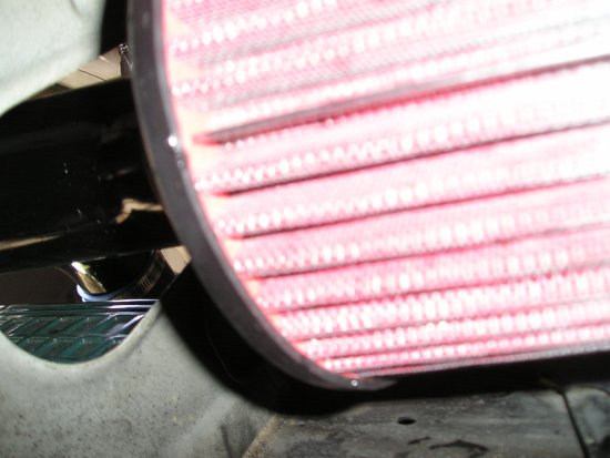

This is the part that goes into the fender well
This is when you look thru the part of the car where the fog lights usually are

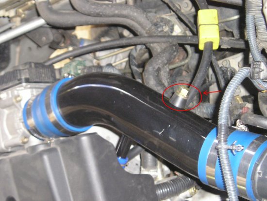

There are two of these (part circled in red), the middle of the rubber has a hole that goes straight through the aluminum pipe.. i blocked it up but i dont know if i was supposed to..
Any suggestions as to what they are for?

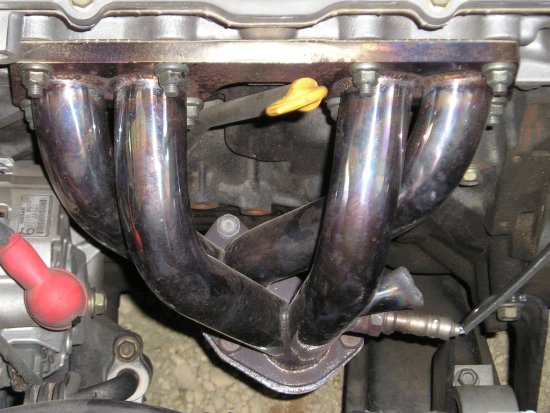

And this is d extractor, no problem with this except alot more noise

do you all think dat intakes and extractors will allow the engine to burn lean? how can i determine if it is burning lean?
X2
Posts: 8649
Postby X2 » September 10th, 2007, 2:00 pm
both free flowing intakes and larger extractors will allow the engine to have more efficient combustion and burn leaner yes.... enough to blow up the engine... unlikely.
The easiest way to check if you are running lean or rich is to read your spark plugs. If you don't know what to look for... do an internet search, I am sure there are 100 sites telling you what signs to look for and a method. If not... come back and ask... i'll type out the procedure.
