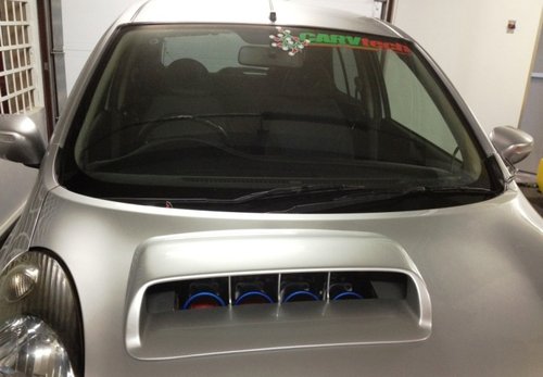

Well it's been a long time. Tuning and hopefully ready to make some runs in Camden in March.
Hope you like......
http://www.carvtechpc.com/carvtech-projects.html
click on the link with the March to see a few pictures. Dyno sheet will go in there once finished.

With the scoop and ram-pipes facing forward I discovered a terrible combination.................with the rain. Hope I can get it tuned for this Sunday.

Well it was pressure. In short:
Tuned on the dyno on Friday and Saturday. Chasing the cam timing and trying to get it correct. With the ITBs on top of the motor it's a PITA to get to the cam gears so things are slow.
Anyway, went on Sunday to Camden in an attempt to see how it behaves.........not to hammer the car!
1st Run: Start only: Front wheels shook loose (I forgot to add 1/4 spacers to seat the wheels correctly). Two years since driving last, so I simply forgot about this.
2nd Run: Start OK, ran through 1st, into 2nd and onto 3rd........car leaned out drastically so was not able to push it.
On the 2nd run I found that the throttle linkage hit the scoop and bent over not allowing the car to idle. From the engine torquing backward.
The lean issue seems to be as a result of having the Ram Pipes facing forward and as road speed goes up so does the inlet air pressure..........learning curve!
Also with the SR16 I used to run out to 9500rpm, so 22in slicks were OK. With this motor I am holding at 8000rpm, so the 22's are too small. I need to put on some 24's and try again.
No use of Nitrous at all. Not ready for that yet.
So it's back to the dyno sometime this week to check on the cams again (changed timing again today).
Now have the ECU monitoring inlet air pressure at the Ram Pipe entry, so we'll see if this helps the leaning issue.
All told a steep learning curve while trying not to hurt the engine or damage the car.

Well the car ran a 13.0 on 100shot with the SR16.
This engine (without nitrous) already makes the same torque and power as the SR16 did on nitrous.
Once I get the cams timed optimally to suit the extractors and the inlet manifold I plan on hitting it with a 130shot.
The car will not make 400whp as I originally planned, I do not want to break the gearbox or the engine. This engine was originally built dry sump for my circuit car, so it is not designed to use nitrous.
Based on the target power numbers and the calculator I use for ETs the car should be capable of mid 11 second 1/4 mile times. Will it, probably not, as Camden for some reason seems to be about a second slower than the proven cars are doing now.
To be honest, I just want it to work well, forget the time, I have not driven this car in two years and to park it up again with a damaged engine or box would be a shame as I hardly ever have time for these things.
