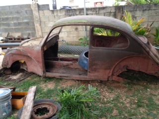

Postby mickel15 » January 28th, 2015, 5:37 am
build coming along nicely

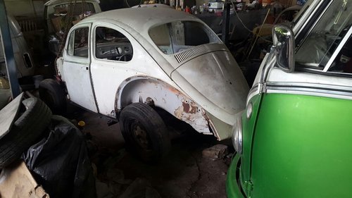

Postby mickel15 » February 6th, 2015, 2:07 pm

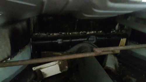

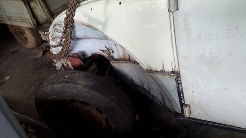

Update .......car was wielded together be previous owner so I had to order heater channel and have the car separated and install the heater channel and get it body bolted to the chassis ...the correct way so pics to come soon

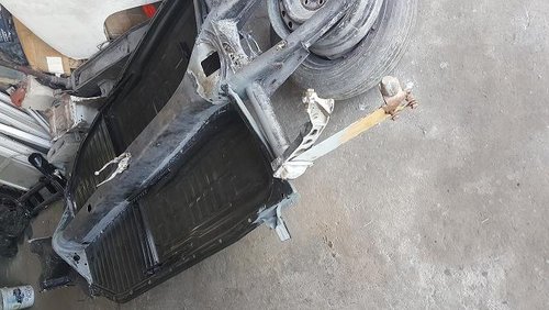

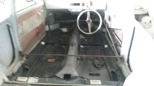

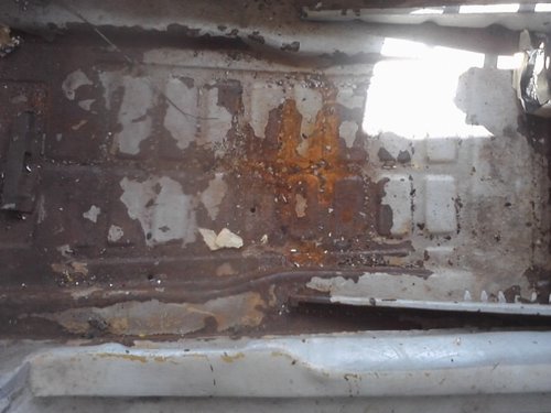

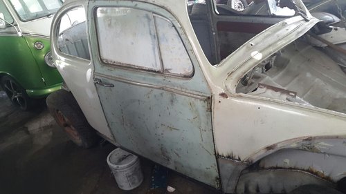

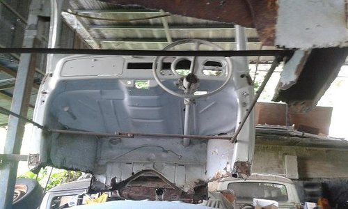

long awaited update
WORK HAS BEGUN FINALLY!!
Car had been welded together ( body welded to floor pans or chassis ) so needed it done the correct way so had it cut and NEW heater channels, floor pans and bulk head put on. well can't seem to get parts in trini so had ship in everything even a set of used doors.

Postby mickel15 » May 20th, 2017, 9:02 am
The beginning

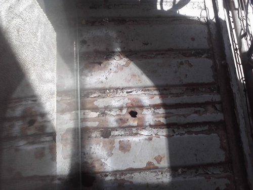

Postby mickel15 » May 20th, 2017, 10:30 am
floor work
floor work new floor pans and bulk head

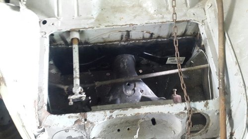

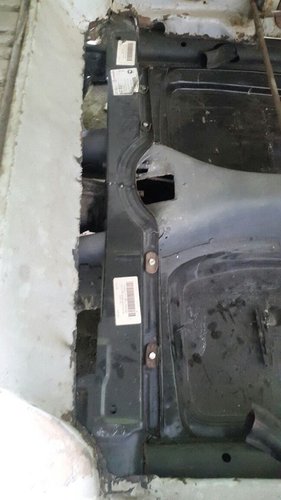

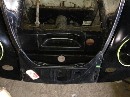

Postby mickel15 » October 15th, 2017, 2:55 pm

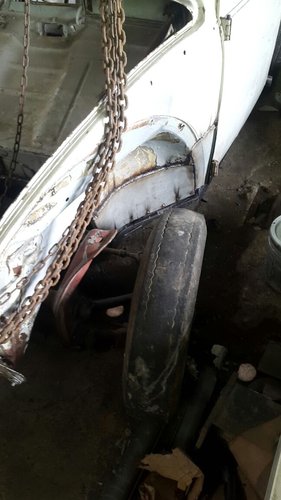

So heater channels were put in and the body was prepared so it now bolts to the floor instead of it being previously welded. The inner fenders were repaired and the lower door posts were replaced so the doors can now fit up correctly. the entire luggage compartment was remover and replaced with a new one (pictures coming soon). Up next the entire front apron and rear fender inner section is to be replaced, line up new fenders and bonnet and prepare to paint.

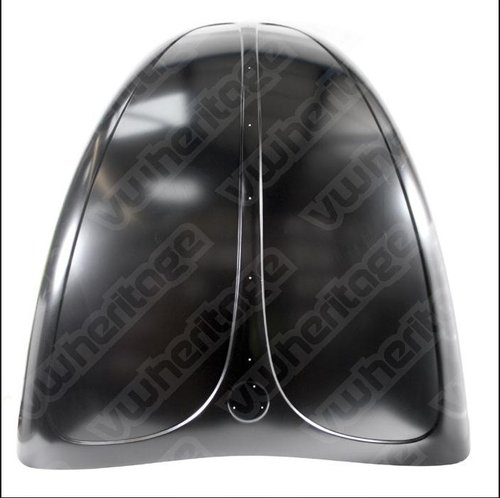

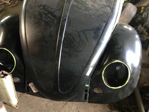

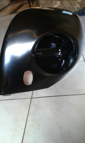

Postby mickel15 » December 6th, 2017, 8:43 am
Ordered the final set of body parts new bonnet and 2 new front fenders should arrive soon.

Postby mickel15 » December 26th, 2017, 11:22 am
Parts have arrived :D
