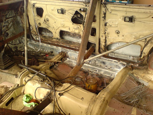

cookiemonstar wrote:this is where she currently sits... she stood up very well over the years no major rotten spots what so ever.
only thing is the frame rails are smashed up pretty bad, considering cutting them out and replacing.
If you don't mind a suggestion, BEFORE you remove major sections of chassis rail, you should either...

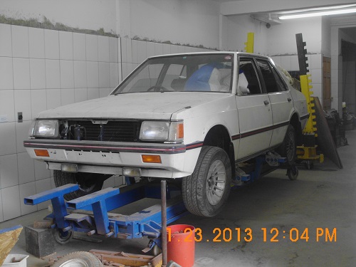

(1) weld braces to the shell (A, B & C-pillars, etc... + under-floor.) (Hard to do repairs but reasonable support)
Lancer82 GSR Boxtype_sized 14.jpg (107.45 KiB) Viewed 3692 times

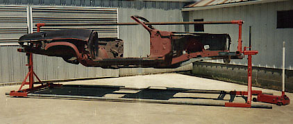

or (2) clamp the pinch-welds to a chassis alignment bench... (Hard to do repairs... but optimal support.)
or (3) bolt shell to a well designed rotisserie (Easy to do repairs... with excellent support.)
If not the chassis may sag... and you'll NEVER get you car aligned correctly again.
The Lancer is NOT a very stiff shell. It has 2-piece chassis rails & large sections of rear floor are unsupported. :roll:
Lancer LT 07.jpg (153.03 KiB) Viewed 3692 times
IMHO option #1 is the most difficult... but still cheapest, unless you rent option #2, or better yet, make option #3.
NB: Remember to support the shell on axle stands before going underneath to do repairs (option #1.)
Dozens of people are KILLED every year when CARS FALL ON THEM!

Sanctifier wrote:Option 1: Weld studs (old bolts) to damaged sections and get a body shop to pull out damage first...
Then use angle, c-purlin, etc. to "box" (reinforce) repaired areas (extend at least 3" more on either end.)
It will look like hell but will be strong (& cheap.) :wink:
Sanctifier wrote:Option 2: Use new metal of the same gauge or thicker...
Use support option #1 or #3 to brace shell...
Fabricate (& bend) rails to match originals...
Drill out spot welds... & swap chassis rail sections, secure with new plug welds...
IMHO you should get "professional" help (if they have equipment) for 2nd option, before you "screw up" your good shell.
After either option, weather proof with "3M sealers" etc... Temporarily seal ALL threaded holes, drain holes etc...
FILL with FoamSeal or Terocore to eliminate future (chassis rail) rust...
[Use in rocker panels + A & B pillars to eliminate rust!...
Run wiring externally or fit conduit first or wires will be 'buried' forever.]
Expanded urethane foams (use type for Autobody use ONLY!) do a GREAT job of stiffening the shell too!
btw... IMPORTANT... & CHEAP! :lol:

another thing i was thinking of, do you think its a good idea to "box" over a new frame rail over the existing one? that might save me the work of cutting out the old one and so on....
just a thought.
Sanctifier
Posts: 3768
Location: Good question!
Re: A172 Lancer RB20DET Project
Postby Sanctifier » July 24th, 2015, 1:53 pm
^ ^ ^ Yup, that's "Option 1" above (20/07/15)...
IMHO the 'box' should also include flanges on either side (slightly wider than originals)... with small holes through the entire structure... then plug welded, 'dressed' with a grinder & 'sealed' (3M?) afterwards.

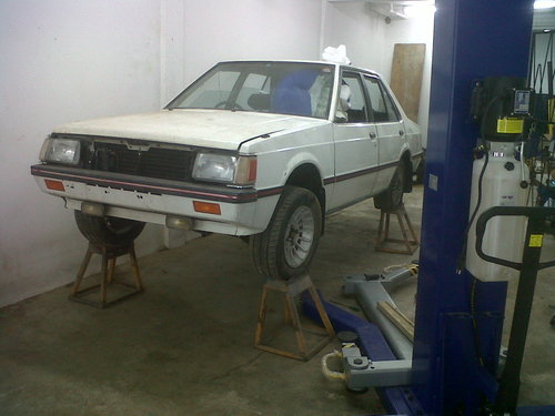

from my research, it states that the car should be on all four wheels to allow the natural flex of the car.
i can place jack stands under the rear axle but, im a bit skeptical of doing the same under the front control arms. doesn't sound too safe.
if i do decide to do that i will place two more stands under the front cross member, not to hold the weight but to be there in case the other two fails.
Sanctifier
Posts: 3768
Postby Sanctifier » July 24th, 2015, 3:50 pm
^ ^ ^ SUPPORT: This is a reasonable alternative if you don't have access to a rotisserie...
A bit tedious to fabricate... but it offers reasonable "under wheel" chassis support, you'll have...
"Under-wheel" support... SAFETY!... with some access & working room.
... and your extra axle stands under the rear axle & front cross-member won't hurt either.
Just remember you can't remove big sections of chassis rail because you have no 'pinchweld' support, so you'll still get chassis sag.

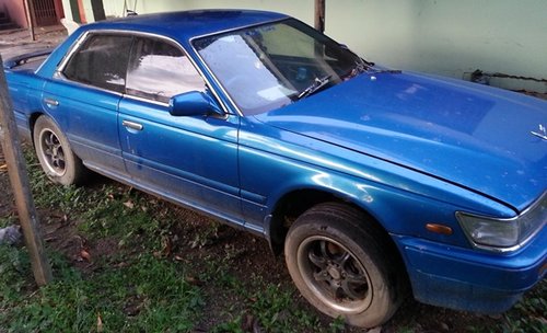

alright guys... ive decided to put the box lancer project on pause and use that poor RB20DET that has been sitting for a while now. pics up soon
cookiemonstar
Posts: 110
Joined: June 21st, 2012, 1:37 pm
Re: A172 Lancer RB20DET Project paused... new project c33 la
Postby cookiemonstar » October 14th, 2015, 11:15 am
new project c33 medalist..
i will still continue with the lancer. maybe now i can go a little more extreme with it? :lol:
