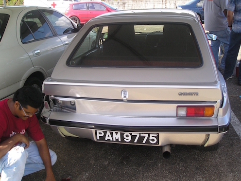

by the time I had a fun car, those days were over :(
My brother did manage to back it into the pit wall some years back :-/
What became of that Capri tho?

I never got to drive the HSR until I was probably 28.....and never really limed / played the arse with it because 1: impossible to get part, and 2: it's very unforgiving and you don't want to provoke it into biting you...it WILL kill you if you play the arse at the wrong moment....that Wallerfield shunt was stress.....could not locate a new-old stock tail light, and ended up with a used one off a car. it was covered in moss and mud, and the reflector is dodgy, so the brake light isn't as bright as the right side one.....still trying to source a new one :-/
Luckily, the tailgate flew open on impact, so wasn't really damaged except for a cracked bit at the top.....tailgates are part of the fibreglass kit, so a replacement would have to be special ordered. The rear windscreen rubber is unique to the fibreglass tailgate, so that would have been a whole other drama....car was unscathed for over 25 years, and he just had to put it into the wall :-/
This is what happens when you tell your brother to stop babying the car like a meow

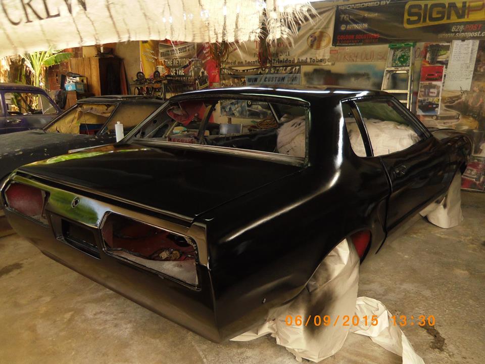

Postby V8 Boys » June 11th, 2015, 9:14 am
First phase of color down....
Next block sand and double coat, then clearcoat at least twice.

Postby V8 Boys » June 28th, 2015, 12:15 am
I'm aiming for a mirror finish! One more pass with the 2k black, then it's cut with 800wet and then base coat black and double clear.
Tranny came out today...gearbox should be in by next weekend.
Engine mods start soon.
