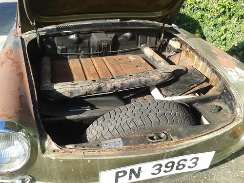

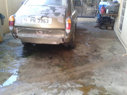

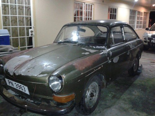

I wanted to know if anyone knows where I can get the body for this car done at a reasonable price.

Mr Heeralal, nice car!
She does look like there's quite a bit to do though. I'm midway in the "rustoration" of the 69 in the video below.
The owner is choosing to NOT paint her (we're doing a "patina's look" with a flawless interior and air-ride suspension on Fuchs rims) and we're almost done the metal work...which was quite extensive in this Fastback...it was soooooooooooooo rotten!
Usually these late 60s Type 3s were victims of years of 70's style bodywork. Acetylene welding and loads of cheap local filler....and Permobel!
I can see that there's rot in your apron, both front and rear, qtrs and some poor filler work. I start by stripping to bare metal and epoxy priming as I go along. Building and fabricating parts as we go along.
Then there's the "new parts" that you'll need...the lights, lenses, the trim, rubbers, etc....they can be expensive as very little can be sourced locally for these V-dubs.
So, a good job will hardly ever be "reasonable" especially when very few and I mean very few body shops are willing these days to take on "ol car work".
My shop specializes in older cars and so does Marcus of TG Motorsport also of San Juan.
Feel free to give me a call at 770 7791 to talk. I'll be super busy from this month til May and projects/jobs like these usually take months to complete.
