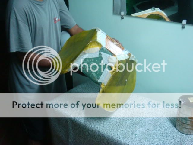

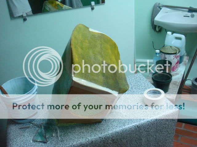

The baffle
The slanted edge allows the factory glove box to open without restriction.. I ran out of hot glue, hence the duct tape..
A cloth was pulled over the sides and soaked in resin.
Simple masking tape was use to keep it in place..
It was then hung upside down so the wet resin soaked cloth would 'balloon' out a bit and form a nice smooth shape.
So far, the sides are coming out as intended. I doubt it would be intrusive to any rear passengers..
as soon as the cloth dries firm, I will put down a few layers of fiberglass for strength and see how much volume i end up with..
Sundown recommends a 0.6cu.ft enclosure tuned 30Hz for the E8.. Hopefully, i'll be close to that.. If not, a 0.28cu.ft sealed (Qtc - 0.7) is recommended..
