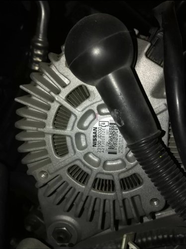

I think the "Tiida" alternator is the highest amperage OEM that you'll be able to find easily and cheap. If you're going with the Tiida, here are some things I noticed from what I've seen so far.
Afaik there are also a 90, 110 and 120 amp that come with the HR & MR engines. Some people try to pass these off as the Tiida 140 amp. The 90, 110 and 120 amp are identical and are made by Mitsubishi. The Tiida 140 amp alternator has a plastic back and is made by Hitachi. The Tiida also came with the 90 amp Mitsubishi unit. Y12's came with the 110 amp.
This is a pic of a 120 amp from a MR20. All of the others look exactly like this. If I get a good pic of the 140 amp, I'll attach it.

There is a 150amp nissan alternator also, I think in came in the nissan March.

Rage Warrior wrote:There is a 150amp nissan alternator also, I think in came in the nissan March.
150 amp you say there Rage. That's with the CR engine, HR engine or both?

Have one put down, I'll take a pic. Really can't remember, it's not hr cause it's not bolt for bolt in my hr15 tiida, need to make bracket that's why it pack down lol.

K13 March and Note I think
