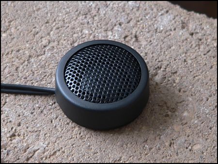

onlystunna wrote:well actually they are just circular and plastic about an inch in diameter.

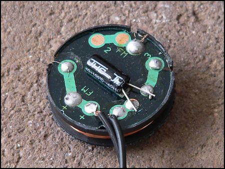

Aargh.... do they look like this?
... and like this, if you open them?

Postby nervewrecker » January 19th, 2010, 11:06 pm
by chance its not these:
anyhow, leme help you catch my drift:

[quote="slacker_jack"]by chance its not these:
That's like the same damn ting with a different outer shell :). Quite a few people like them because they're as loud as hell (100dB/1W!). Of course it's not made clear that they probably can't handle very much power...

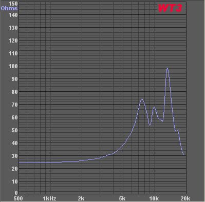

Here's what the reverse side looks like. Notice the ELECTROLYTIC CAP...
...and here's what the impedance response looks like with the cap bypassed..
It might take more than a 2.2 uF cap to make this work better. Bypassing the internal capacitor, hooking a 4 ohm resistor across the leads and then connecting a 2.2 uF capacitor in series with this might give better results.

onlystunna wrote:ok so i checked the high pass filter on the amp and its at 120Hz. And yes the tweeter looks exactly like those Power Acoustik tweeters except its not Power Acoustik, i dont know the brand of them its not written. Ok so what shud i do?
120 Hz is WAY too low a frequency. Multiply that by 60 and you might be in the ballpark for what might work best with that tweeter.
Why don't you try what I suggested?
Open the back of the tweeter. If it looks like what I've pictured above, it's the same damn ting.
Let me make it a bit easier to follow:
1. Bridge the internal capacitor (just use a piece of wire across the capacitor's terminals)
2. Connect a 4 ohm, 10 watt resistor across the tweeter's terminals.
3. Connect one of the tweeter's terminals to the amp's negative output terminal.
4. Connect the other terminal to a 2.2 uF capacitor
5. Connect the capacitor's other terminal to the amp's positive output terminal
This will put a 10kHz 6dB/octave filter in series with the tweeter (the 4 ohm resistor basically flattens the fugly impedance response of the tweeter at high frequencies, and yes, it's required).
The tweeter's output WILL go down a bit, but it might integrate a bit better with the rest of your stuff.
If it's too low in level for your tastes, try a 3.3 uF capacitor instead.
If all that doesn't work, buy a better tweeter :-)
