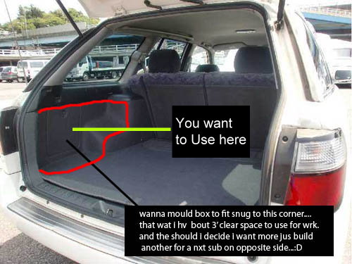

ok..i currently hv a 8" dd sub in my wagon...
the thing is that due to having to use the car for work as well, alot of times i have to move the woofer box to accomodate the materials etc being transported...
my solution for this is to build a fiberglass enclosure to fit into one corner of the back that would resolve my problem...
i am familiar a tad with the proceedure to make the enclosure.. however, the issue is how do calculate or go about getting the correct internal volume for the enclosure for my sub to perform properly????
please help...

somehow i dont thik u will get the output from that 8" as from a bigger sub if u do a fibreglass enclosure
but its easy .. many pple use packing peanuts and just build a 1 ft^2 box and measure from there
Re: need help.... fibre glass enclosure...
Postby nervewrecker » October 21st, 2012, 8:35 pm
how much space (internal volume) the sub needs btw?

dd 1508 performs quite well in a 1 cf ported enclosure.
you dont have to build a 1 cf box, take any box of known volume (could even be cardboard) fill with packing peanuts (could even use sand if available) to your desired volume (if the box tou choose is less than/more than 1cf fill to appropriate.
take some large plastic bags (garbage bags - double up if using sand) fill with your measured volume and stuff it into the location you are considering.
this would give a fairly accurate idea of how much space the box will take up.

Postby smallz » October 21st, 2012, 11:16 pm
thks for d feedback fellas...
and correct..
its a dd1508 dual 4ohm sub...
see pic posted for the area i plan to fit the enclosure.........

also...sorry if its a silly question eh but is it possible to still include a port in the enclosure????
kinda prefer ported over sealed...... :|

Yes you can still port the Box. the dImensIons mentIoned before were for a ported box. If you can fIt a 1.2cf box even better.
Actually, I don't think dd recommends using sealed for that sub.
If you are using the entire side panel to tale the mold you should have enough space. If you are using only the area that you pointing to where the cutout is, you may not have enough.

Yup.... I'm able to utilise dat whole area if necessary.... :) an so far this seems to be headed in d right direction....
So... I'd have to go wit a round port orrr????

Postby Firewall » October 22nd, 2012, 7:28 pm
Round might be easiest.....pvc.

make a rough measurement with a ruler self to get an average of the volume from below that black finisher (the hollow and the space above the tyre hump there).
It will look nice if you flush mount it with the face of the hump, I did something similar for a rav 4 recently, I will see if I get some pics nest time I see the van.
I think the DD site recoomends between .75 - 1.5ft^3 for that sub and it has port area and length as well. Depending on what you like you can tweek the length to suit.

smallz
Posts: 196
Joined: August 18th, 2010, 9:27 pm
Location: south
Postby smallz » October 23rd, 2012, 5:28 pm
@ nervewrecker.... i frm la romain... well 1, i have the sub already an 2, i plan to get the materials for the project dwn by d place by d warf dat does sell all dem kinda fishing supplies an fibreglass ting....
the part bout beginnin sanding when its semi cured.. i saw that in another forum so that part is noted..
wel pertainin to the enclosure, i gonna do the bottom and sidewall in mdf so i can have the flush mount effect... not sure entirely if i putting the sub at any angle or anythin.. if i do. is for no particuler reason.. only for aesthetic gain... but more than likely not as i wanna include stratchin the fleece to get a sort of stock look to the ends of the enclosure so it blends back to all existing trim and mouldings..
