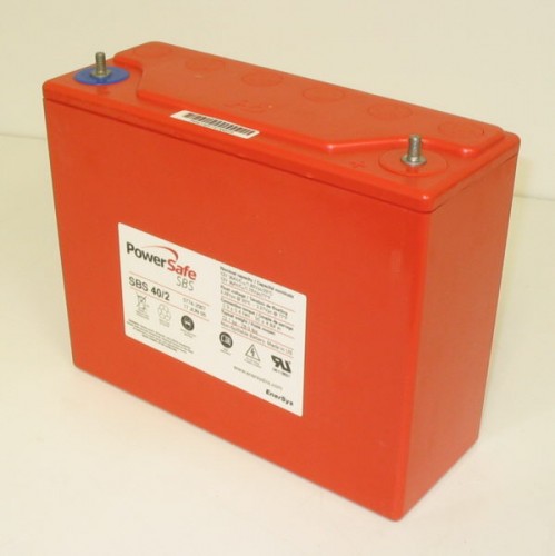

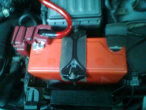

Hello trinituners. I have an Y12 wingroad and using a Powersafe SBS 40 battery for nearly a year now but have a little concern about my voltage ever since I bought the battery. By the way I never had any starting problems. Car starts perfect. :D
With car off just battery voltage no load, no charge is 12.5 – 12.7 Volts. :D
Starting the car cold with engine running but everything switched off the battery read 13.8 – 14.3 Volts but the voltage drops over time in less than 2 minutes to 13.2 Volts at idle and stays there. :?
With engine running and everything on (lights high beam, A/C,) the battery read 13.1 Volts and with music on loud (2 amp system) drops to 12.9 volts when a bass note hits at its maximum volume with lights dimming very slightly (barely noticeable).
With shutting everything back off, but engine running the battery read 13.2 volts.
Shutting the car off, the battery read 12.7 volts.
My only concern is why does the alternator start out cold putting out over 14 Volts and after warming up stay at 13.2 volts? I checked 2 electricians and they said that once the car is starting good and voltage is over 13 Volts everything should be fine. I will like to get some of your opinions on this issue.
Thanks very much and looking forward to your replies. :)

Hot rating of an alt is less than the cold rating so hence the output is less
Also that powersafe battery was not made for automotive use but for the telecom/ ups industry and was not designed to handle heat and vibration in your engine compartment
