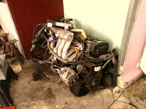

I doing similar project on my sister's Tercel but i am using back the old transmission after i put in fresh oil in it,4efe cost me $3500 complete engine.........

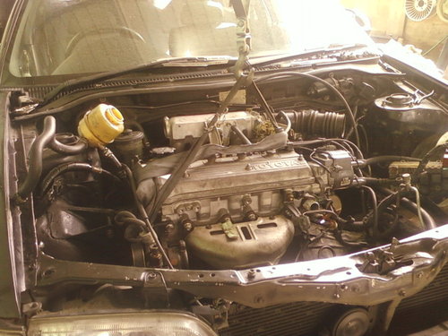

And make sure the electrician doh have your wires looking like a bird nest again eh. Dem pics of d old engine looking shameful...show d engine bay some love. It hadda be wukkin good and lookin' good.

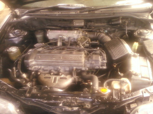

As i said this is my sister's car,if i get ah power washer borrow i will clean the engine bay or i will just pay to have the car cleaned up after i am done.The new 4efe spotless no oils spills on it so i leaving it just so,i soaked the transmission in purple blaster so it would look ah bit better when i put it back up.The electrician charged me $700 to wire it up & i use him before and his work is neat.Still have to figure out what i doing about the pump cause i did not open the take yet to see if i can work up an internal pump or just put an external 1.
I have the head,carb and distributor for sale if any 1 need s it @ 7674466..........

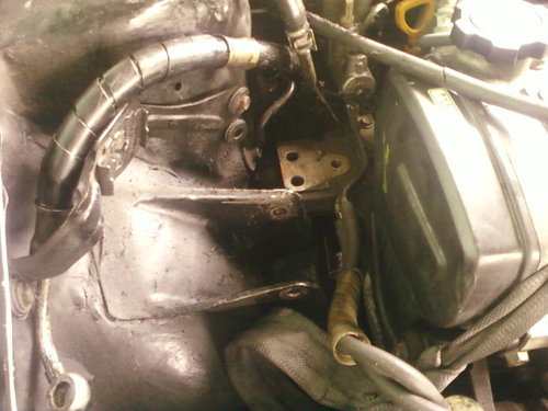

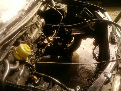

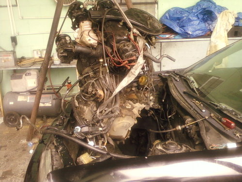

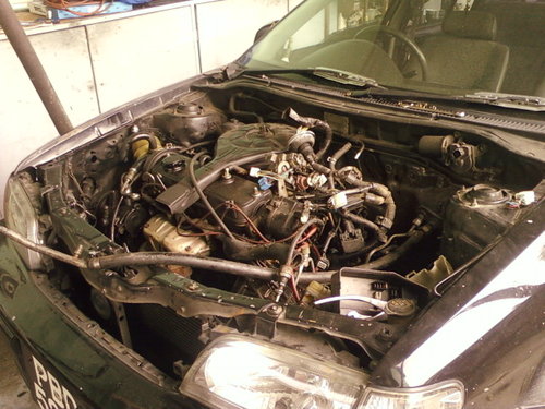

Update on my project,i put in the engine only to realize the engine mount bracket different ,cause the engine i use came out of ah 111 not ah Tercel so i had to scrap the bracket from the old engine & scrap down the side of the new engine for it to work,next problem was the muffler,i did not get the down pipe with it so i had to go look for 1.After that was to put the pump in the tank & wire and gas back up the A/C.

could we get a pic of how u eventually worked up the mount?

Hook if it's my project your talking about when next my sister's is around i will take 1,but i looks stock cause i scraped the original bracket off the 2e & it worked back with no problems bolt for bolt & i use back the original 2e mount for the bracket.P.S. to any one buying ah 4e or 5e offer up the right side mount before you put the engine in the car if you working on ah Tercel............

to answer Hooks question abt the right side engine mount is because most those engines came from a corolla an the mount brackets on the engine are different for those as the engine bay is bigger, but it is simple as unbolting ur stock bracket an using it back...

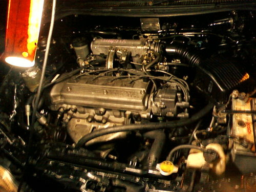

the pic basically shows where i started to where i'm at for now... 2E>4EFTE>5EFTE
