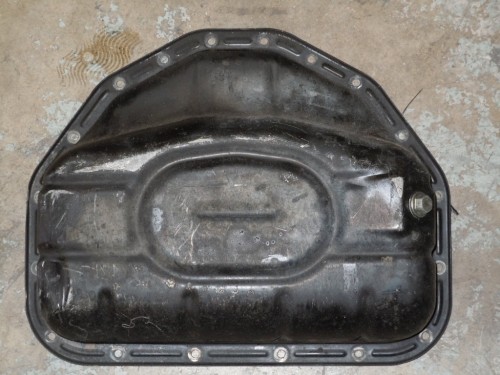

yeah ebay mostly. some from my.is. i have tons of pics but i never got around to do a build tread. usdm drive shaft (front) in pic. no adjustment required. figs race arms and toe link in second pic with TRD suspension. i wasn't there for the engine bracket and mount. install so no pics of that.. oil sump mod from graham B. i got the idea from him. but if u get a usdm oil pan or one from a jzx110(?) it should already have the contour u need to clear the cross member
is300 front sump
fig's rca
modded jzx100 front sump
is300 drive shaft installed
