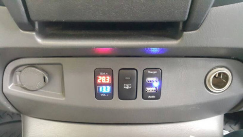

Got the miccon turbo timerbinstalled today at the expensive electrician on my side.
Carried my own t-tap splice connectors, so no wires got cut.
Also installed these 2 units:
Temp/volt meter and a 2.1A USB charger with an outlet for audio (to connect to a new head unit in the future)

*$kїđž![emoji769] wrote:Hey i likr those thr volt meter and the extra usb...where did u get those...also how did he install them...did he havr to take out any part of the dash..?..
Voltmeter usb from amazon.
Turbo timer is miccon, from ebay.
He charged me 300.
Dash wasnt removed, just the cowl behind the steering and the switch panels.
