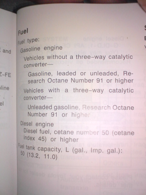

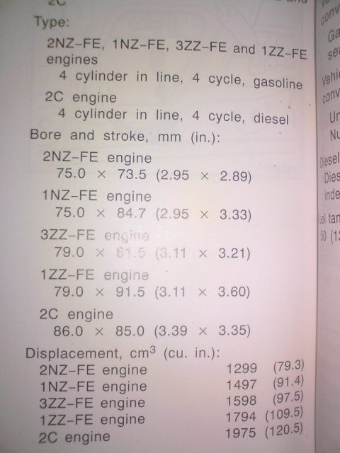

Postby joe_d_boss » November 7th, 2008, 4:30 pm
As someone mentioned before, the local Toyota Corolla comes with the 1NZ-FE engine which, as stated in the owner's manual, REQUIRES Research Octane Number 95 or higher unleaded gasoline.
The 2NZ-FE, 3ZZ-FE, and 1ZZ-FE (found in the foreign used vehicles) may use Research Octane Number 91 or higher.
The question I want to ask is: Apart from maybe a little loss of power etc., would using the Super unleaded cause any major damage to anything in the long run?

joe_d_boss wrote:As someone mentioned before, the local Toyota Corolla comes with the 1NZ-FE engine which, as stated in the owner's manual, REQUIRES Research Octane Number 95 or higher unleaded gasoline.
where are you people getting this information.
the local 1NZE require 91 octane or more
joe_d_boss
Posts: 214
Joined: December 23rd, 2004, 3:49 pm
Postby joe_d_boss » November 10th, 2008, 12:44 pm
^^^ I got my info on page 295 of the Corolla Owner's Manual. What better source can there be? I am curious to know why you think that the 1NZ-FE (not 1NZ-FXE) can use RON 91 and where you got that information because I would certainly like to switch over to super if it is possible.

Postby dmitc » November 10th, 2008, 2:07 pm
from my mrs local 2007 toyota corolla manual
i'll like to see what your manual has on it
joe_d_boss
Posts: 214
Postby joe_d_boss » November 10th, 2008, 2:41 pm
I don't have a scanner readily available, but there is a section in my 2006 manual that says:
"Vehicles with a three-way catalytic
converter -
1NZ-FE engine:
Premium unleaded gasoline, Re-
higher"
[X]~Outlaw
Posts: 1293
Joined: September 22nd, 2004, 1:46 pm
Location: silly hunduh vteck is 4 kids
Postby [X]~Outlaw » November 10th, 2008, 3:05 pm
^^ my 2004 manual says the same thing
1NZ-FE engine:
higher"
joe_d_boss
Posts: 214
Postby joe_d_boss » November 10th, 2008, 3:12 pm
Cool...anyone else can confirm this in their manual?

Postby dmitc » November 10th, 2008, 3:18 pm
well what can i say go with what your manual have in it.
joe_d_boss wrote:I don't have a scanner readily available
i use my camera phone

Postby wickedestman » November 12th, 2008, 10:38 pm
1nz-fe... it IS 91... i will verify tmrw morning when i go in the car...
i running the super after about three fills now, the range went from 420km, to 320km, now its back up to 380km... and the car actually pulling the same now, feels no diffferent... maybe the car didnt fully get accustomed to the Super unleaded yet.
joe_d_boss
Posts: 214
Postby joe_d_boss » November 13th, 2008, 8:53 am
^^^ Well I guess we have established that the manuals do have conflicting information.
