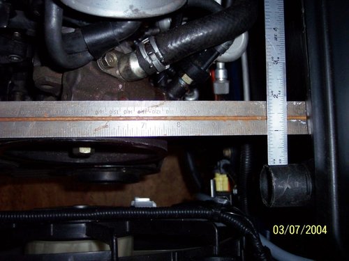

Jigga, i've done the research. the only way you can get "everything" working (im assuming u mean dash temp guage, trc control,power/snow etc) is to continue to use the 1g ecu in parallel with the 1jz. i.e the the 1jz handles all engine and the 1g multiplex handles everything else. some signals will have to be shared between both ecu.
i'm chatting with a guy (graham) that did the same swap in the gxe10, only difference is he used a full stand alone for the engine and spliced the oem 1G. he also said if he had to do it over again he'd keep the oem 1jz ecu cause it handles the vvt-i better than the stand alone.
the thing is we have to find somebody that is willing to take the time to do it, cause it is a tedious job and then we have to pay them for that time.
so far, using his input and advice, i've mangaged to keep my oem fans, rad etc cause i've modified the jz engine mounts. the engine now sits 75+mm farther back and i think 20mm lower in the engine bay. also i don't have pics of mine (but u can see it in person if you go to the garage) but here are some pics of his

seecarr11, couldn't you have used the is300 JZ engine mounts to sit the engine in a stock position? I'm planning to put one of the 1jz vvti in my car but i can't seem to source an aftermarket manifold, know of anyone with any?
seecarr11
Posts: 230
Joined: January 27th, 2008, 8:12 pm
Re: 1jz vvt-i turbo
Postby seecarr11 » March 14th, 2011, 2:51 pm
yeah i could have, however it would mean that the stock radiator fans would have be changed to the slimline ones, existing holes for the tranmission would have to be redrilled and some other misc stuff.
the main advantage of what i did or hoped i achieved was moving the engine center of gravity/weight backward to help main the 50/50 weight distribution. that is also the main reason i choose the 1JZ vvt-i over the 2jz. not so much the cost. the 2jz-gte weighs 279kg, 1jz-gte weighs 220kg, 1jz-vvt-i weights 217kg (probably cause its single turbo so the manifold piping is less complicated) and my stock 1g-fe weighs 179kg, maybe 185-190 with the TTE charger kit. so in short, im a little more busty in the front (now i'm a "c"cup?)but not too much
i drove the car only a few times but so far it still feels the same entering the corners. i'm still confident with that. hp doesn't matter so much there. Also i should mention that my suspension isn't stock. the trd yellow coilovers can take the weight, not the trd sportivo
exiting the corner though, that is a bit more exciting :-) Not so confident there, cause i always had traction control to save my ass before, now....well i'm really glad i invested in that torsen lsd cause that would be madness on an open diff imho
Now i'm not trying to say that a 2jz convo won't work, but for what i like to do with the car, i'm more interested in a car that handles well than a car that can go really fast in a straight line. "the most important thing is balance" - drift king
you're lucky. toyota already thought about all that when they put the 1jz in yours. next time i'll be sure to just "buy it fast" like u rather than "make it fast" . its a lot cheaper in the long run
as for the aftermarket manifold, the vvt-i spacing is different so u won't get it here (atlantic side of the world). i found one in hong kong, brand new, looks really good and already recommended but it will cost 350us plus 150us just shipping to the USA.
I think you should try to fab it yourself

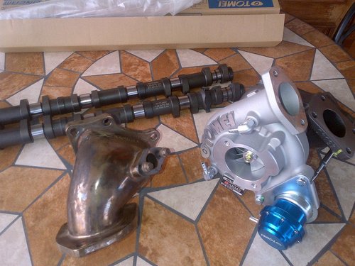

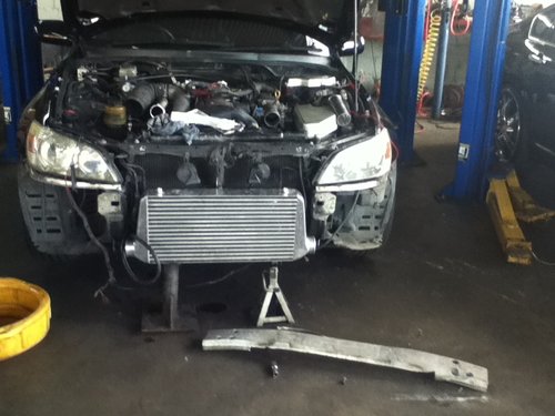

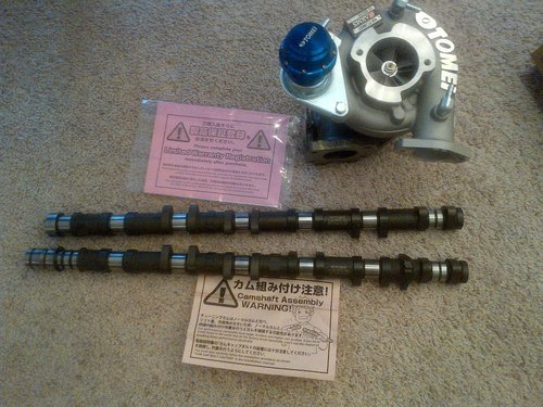

Postby seecarr11 » April 19th, 2011, 1:08 pm
alright i'll post. its still not finished but here are some teasers.

Postby rx80 » April 21st, 2011, 12:51 pm
Auto with stock ecu? Who's doing the electrical for you? Install comming along well man..

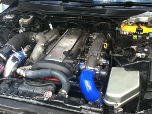

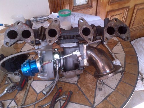

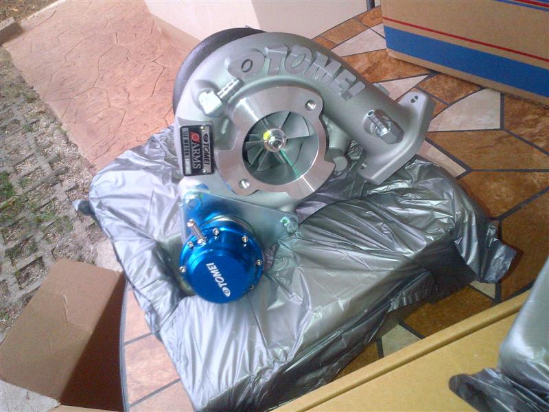

seecarr11
Posts: 230
Re: 1jz vvt-i turbo
Postby seecarr11 » March 23rd, 2014, 12:18 pm
turbo.
attachment=0]IMG-20130811-00056s.jpg[/attachment]
