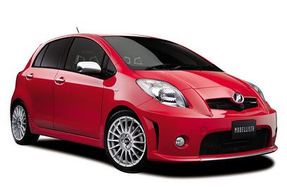

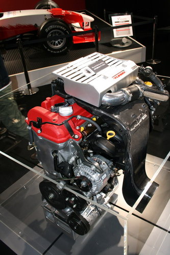

ramishrrr
Posts: 894
Joined: September 17th, 2007, 6:21 am
Location: Marabella
Re: WTK: turbo down NZE
Postby ramishrrr » September 25th, 2010, 6:33 am
This is the REAL DEAL. Not home-made.
1NZFE Turbo from the Factory.
Used in the 2007 TRD Modellista Vitz.
150 HP.
NCP 91 TRD Turbo.jpg (17.84 KiB) Viewed 3772 times
