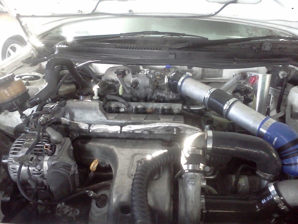

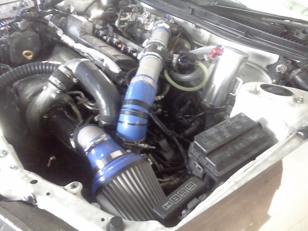

Postby Monster 101 » December 12th, 2011, 11:09 pm
here is a pic of the engine bay

Re: 3SGTE Conversion
Postby Monster 101 » December 12th, 2011, 11:16 pm

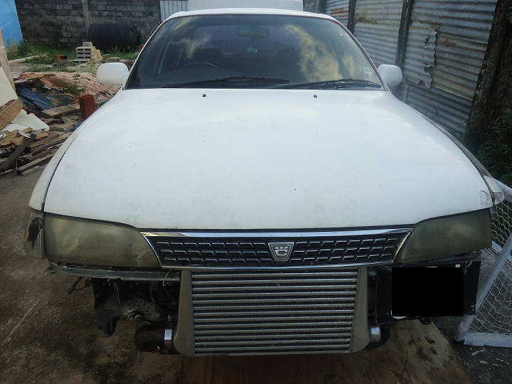

Monster 101
Posts: 507
Joined: December 11th, 2011, 4:54 pm
Location: In Space
Postby Monster 101 » February 7th, 2012, 9:44 am
