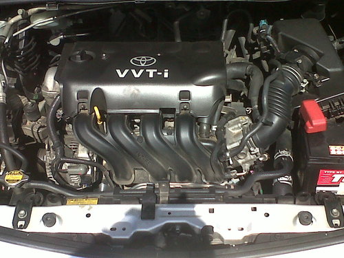

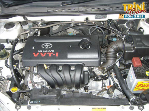

could sum1 tell me the difference between these two engines, and which one parts are more readily available for as well as which one is more robust. Thank you.
1st pic , guessing the same engine that is used in local nze
2nd pic, engine frm an altis.

The 1st one is a 1500cc that come in more Japan cars & the 2nd is a 1600cc that more come in Singapore cars,engine 1 easier to get and much cheaper about $5000 ,2nd engine is Mr engine it self hard to find and can cost you $10 000 just for a head and block..........

but what about the power steering?
The first engine is the 1nz-fe and does not have a hydraulic power steering pump or reservoir. Cars equipped with this motor has electric assisted power steering.
The other engine clearly has power steering.

From what I can see, the first looks to be a 1nz-fe where the second seems to be a 3zz-fe.
Could be wrong, but that is my take from the pics given.
