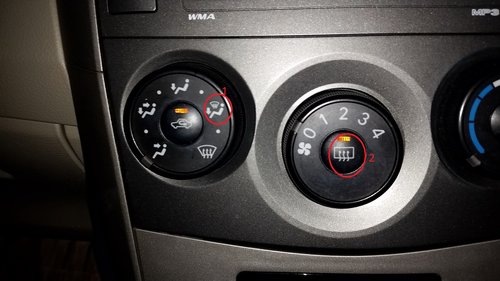

First question, in the pic below we see the defrost, 1 depicts the front wind shield and 2 depicts the rear wind shield. We believe this is correct.

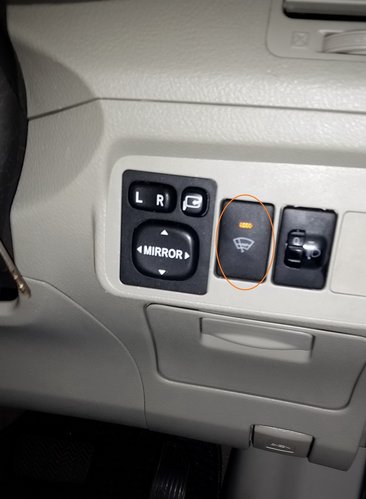

The next pic shows a button circled in orange when depressed illuminates an orange light. The car did not come with a rear wind shield wiper.
Can anyone explain the function of the knob?

First - option to have the front windshield defroster on along with the vent for the front passenger and drivers feet.
Second - this is to turn on the rear windscreen defroster. Thats the lines you see in the rear windscreen.

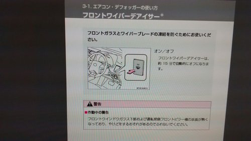

That knob which shows a "rear windshield wiper / washer" is shown in the Axio manual, however it is in Japanese. The manual is also a scan pdf and cannot be copied and placed in Google for translation. Hence I came here for help.
Hopefully some else can chime on it and the operation on the 4WD system.

the light in the last pic.. in japanese is located on the bottom right of the dash next to the fog lights and head light switch.. this is for the wiper heaters ... it is for cold countries with snow. check under your wiper blades you will see copper lines under them under the windshield.
hope i helped.......
