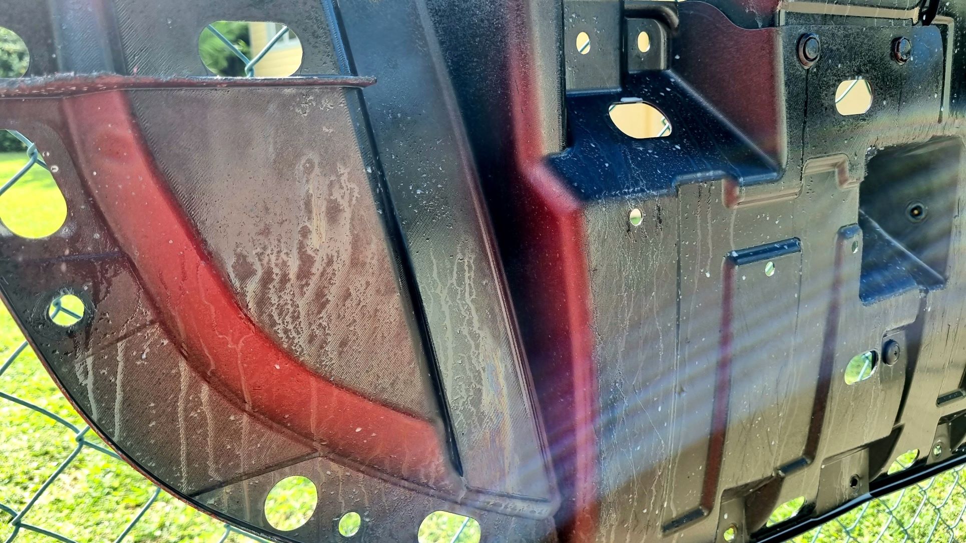

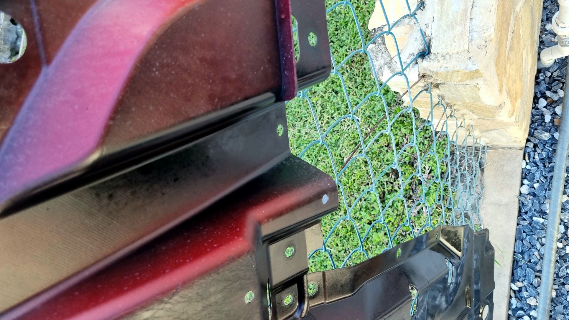

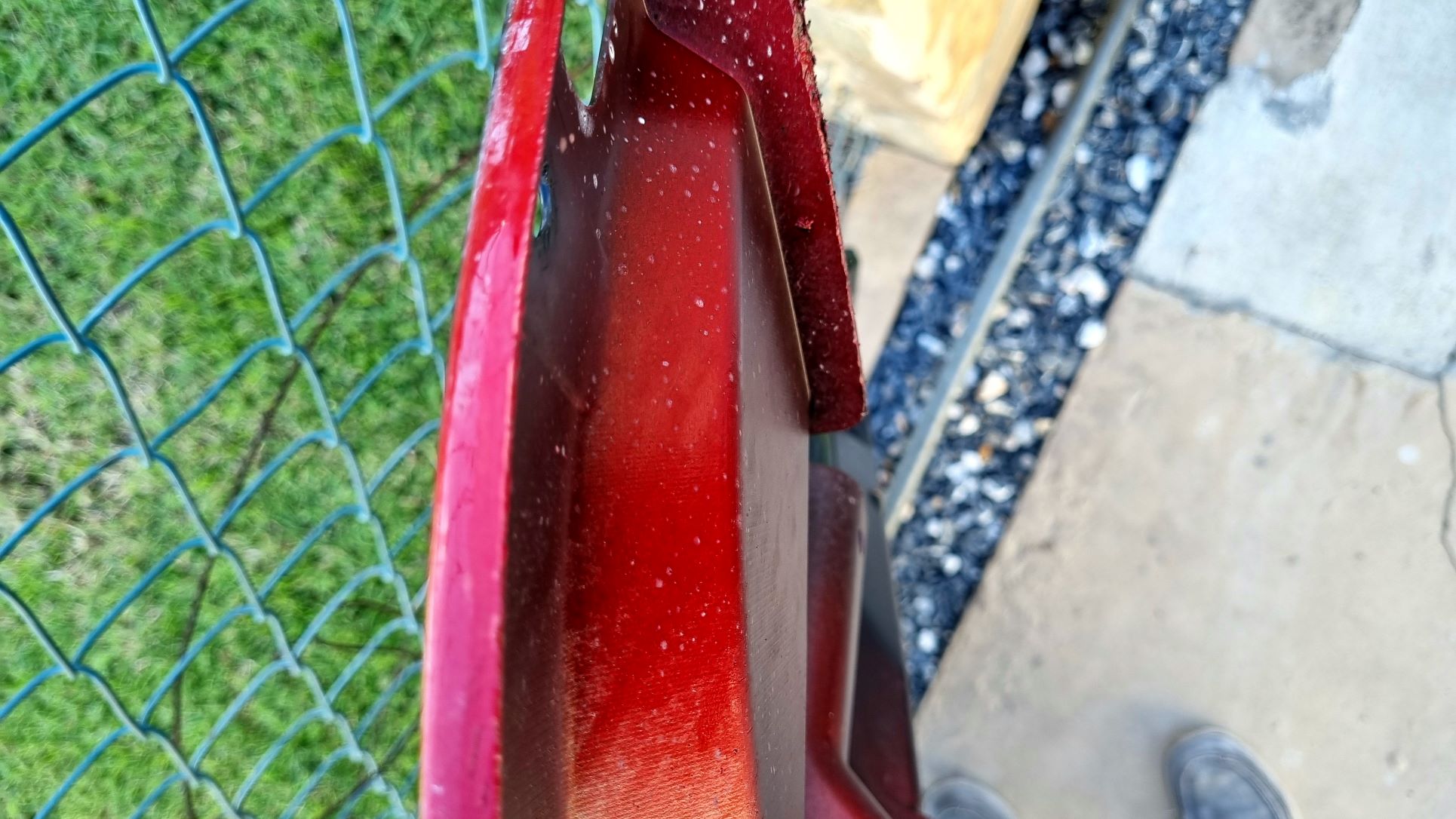

Also some pics attached of their the paint work done...mind you this was just to this area the left front bumper to be repainted due to a 3-4 inch long scratch. Overspray...damage to fog light housing(seems like a paint remover was used)….not even refitted on properly/damage to mesh. Also have pics of the initial color the back bumper was repainted and let's just to say it was nowhere close to evo red but wanted me to pick it up like that, they corrected it but the difference can still be seen(in pic 5 circled in blue is a preview of what the initial red color was used the upper right part of housing). will post on that after just want clarification on the acd/ayc for now as this is a big issue.

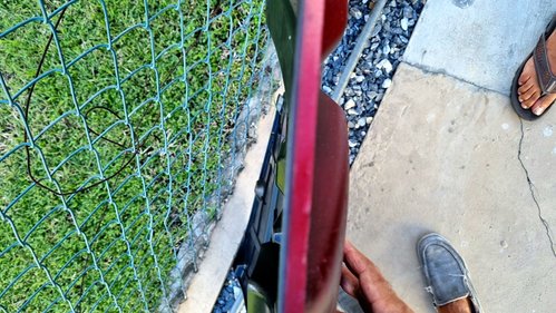

To my delight i got part of my under panel painted for free also. Did not realize the overspray reached or how the hell paint got there when they had fix their mistake. Discovered this Sunday as i was doing an oil change. will let the pics speak for themselves. Take note of the color red...nowhere close to evo red. Just thought i'd share a bit more of the work done by this shop as i know tuner is a United community when it comes to sharing our Automotive experiences.
