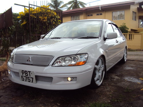

Postby soo » November 9th, 2010, 7:37 am
this is how low my car is now. its on 15"x7" rims. 205/50/15 tyres. it's as low as i want to go.

Rudman
Posts: 2074
Joined: August 17th, 2005, 10:35 am
Location: Finding out all the good tyres in life begins with "R".
Re: Need Advice on droppin
Postby Rudman » November 9th, 2010, 7:48 am
^Soo.......this is how a CK looks with the Eibach Pro-Drop? Nice, I always wanted to know, thanks for sharing.
If i get the chance, I will post up how the CK looks with H&R springs and 15" rims. It looks just about the same.
