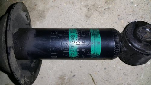

Jade_Inc.
Posts: 713
Re: CY lancer (08 lancer)
Postby Jade_Inc. » July 2nd, 2017, 4:16 pm
Original cy 2015 rear shock oem part number
