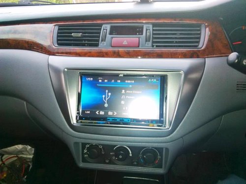

Trinicatalan wrote:Hey guys, anyone here ever installed a double din stereo system in their lancer? I'm thinking about buying a full dashboard with the 2 din pocket and electronic a/c controls? Should i expect any problems or complications?
The attachment 1.jpg is no longer available
I did the conversion in this car. But this car had electronic a/c controls.
I brought down the silver double din trim face plate. Paid $800. (With Shipping included)
The electronic a/c knobs for the relocation at the bottom came off an Evo8. Got it in the bamboo. Paid $500.
I had to use a different trim for the a/c vents to line up. That's why I went with the wood-grain. Paid $300.
The reason I did not buy a complete dashboard is cost '$3000'. For a couple of plastic pieces. Any they were not giving everything with that used dashboard.
Problems: Clock and hazard stock harness was short. Had to buy also and extend.
A/C vents in wood-grain did not line up in the back of dashboard. A/C person
fabricated the plastic to make it work.
For the manual a/c control, just relocated to the bottom and get the double din trim face plate.
PM me if you need any help.

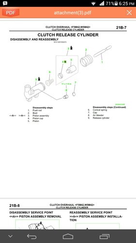

Hey anyone knows where I can get the push rod that connect the slave cylinder to the clutch release fork been searching everywhere can't locate this part. Its number 1 on the diagram below.
Re: The Official CS Lancer Thread!
Postby wagonrunner » February 3rd, 2014, 8:58 pm
redeyez wrote:Hey anyone knows where I can get the push rod that connect the slave cylinder to the clutch release fork been searching everywhere can't locate this part. Its number 1 on the diagram below.
mishi, is that shared with any other hydraulic system (clutch / brake)?

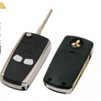

icefox wrote:any one know where i cant get this asap. the key broke off in subway yesterday an fell in the straw holder an i aint even know it...... all them subway grls was helpin me look for my key an jus the remote in my hand..... real shame thing........cus i was real chatting down them grls
icefox wrote:
EXODUS wrote:when a man chatting down subway girls, things rel bad dan...
na man, it had some real sexy girls in subway yesterday :mrgreen:
:lol: :lol: :lol:
About the key, you might have to get one made/cut. You have a spare, right?

You can just get a spear key cut or check online and order a new key shell with blank key and have the locksmith cut out new key for you.
You ll have to remove the transponder/chip from old key into new one

I fit mine into one of these.
Had to do some butchering but it look bess and was functional.
