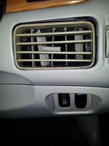

My AC vents need changing, can i buy the vents alone or do I have to buy a whole dashboard to get them?
Is not me have dem vents so eh!!!
