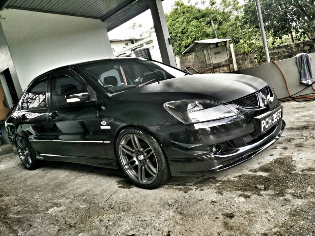

Re: The Official CS Lancer Thread!
Postby Ted_v2 » August 5th, 2015, 6:55 pm
His car legit. Perfect height. Could still hold the weight of the occasional odd items.
