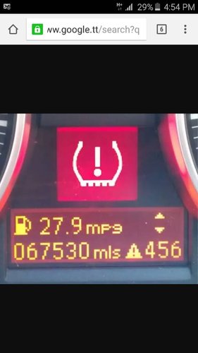

IPES
Posts: 49
Joined: November 23rd, 2013, 1:11 pm
Re: CY lancer (08 lancer)
Postby IPES » January 21st, 2016, 4:58 pm
There is this symboy and the hand brake one...check your tyre pressure with this one..if its the hand brake light ..check brake fluid or disc pads ..

trini iceman
Posts: 461
Joined: January 12th, 2013, 1:14 pm
Postby trini iceman » January 21st, 2016, 6:39 pm
Were tyres rotated?

trini iceman
Posts: 461
Postby trini iceman » January 22nd, 2016, 7:18 pm
Is it the warning light shown by IPES?

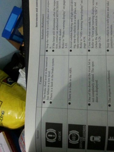

tntrenaissance
Posts: 4
Joined: January 19th, 2015, 11:51 am
Postby tntrenaissance » January 22nd, 2016, 7:36 pm
No it's a red exclamation mark in a circle, inside of brackets and CHECK written underneath. I can never get a picture of it as it happens so randomly and last a second.

A.W.O.L
Posts: 876
Joined: September 5th, 2008, 12:37 pm
Location: ....souping it up..
Postby A.W.O.L » January 22nd, 2016, 9:17 pm
When all else fails go back to the books...
Could be your sensor on the brake fluid res..

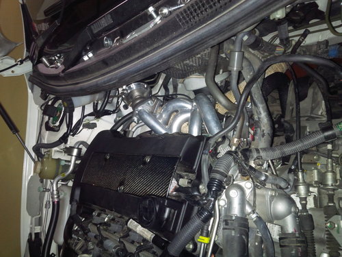

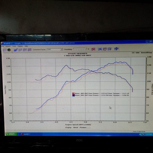

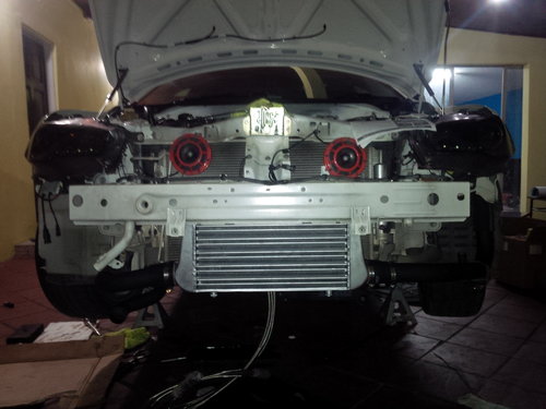

did a baseline pull today before installing the turbo kit next week

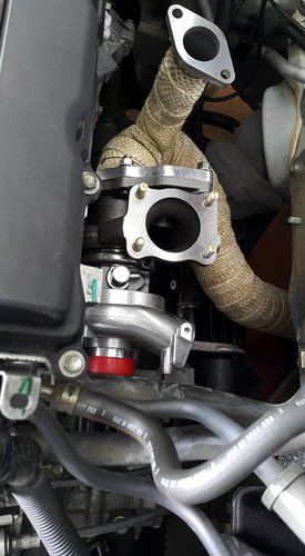

Ignorant Ignis
Posts: 4016
Postby Ignorant Ignis » January 29th, 2016, 9:13 am
in progress.....
ran into a few snags...but its almost done
