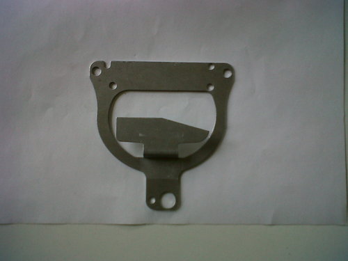

Postby Parvin » February 28th, 2011, 10:47 pm
@ fras
I got fed up of having the light output in the direction as it is stock
________/________/
I decided to open them up and mod the shield.
Right side original shield
I had tried to get different ones cut so as not to damage the originals but the machine shops couldn't get it done. So ..... I tried a lil sumtin.
New shield cut to be added onto originals
This is the projector how it looks.
Projector
Didn't take any more pics as this was only the right side i got completed tonight. Will get the left side pics of the mod shield attached and pics of the light output.
Looks kinda like this for now (from right side light);
__________
...............\_____________
fras
