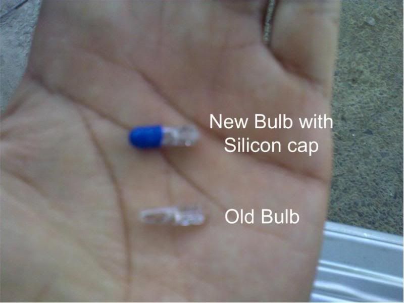

Ok so here is the DIY on changing your Dashboard A/C controls and Center Console
DASHBOARD
1. Remove your audio headunit
2. Remove the cubby pocket under the A/C controls. this is done by removing the two screws shown and pulling out the pocket
3. Remove A/C control dials by pulling them off. there are no screws that need to be loosened

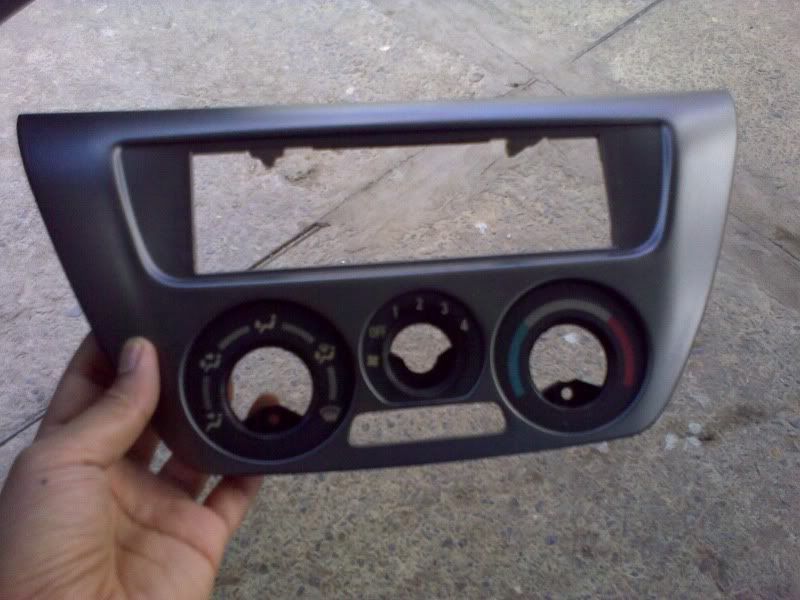

4. Remove the two screws that fasten the finisher to teh A/C controls
5. Remove the finisher
this is done by unclipping the 6 clips that hold it in place and pulling it out

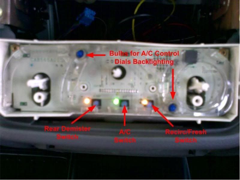

6. Observe the internals of your A/C controls.
It consists of two bulbs that provide the illumination and a light tube that spreads teh light around creating the back lit effect
Bulb #1 & #2 provide teh background illumination for all the controls, while Bulb #2 also provides illumination for the Demister, A/C and Recirc switches
To change teh bulbs teh light tube must be removed
and

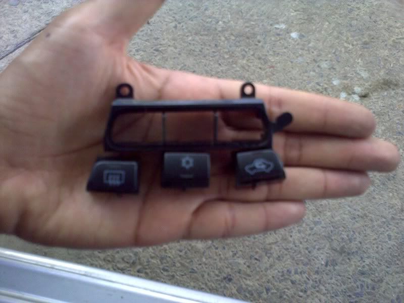

To remove the light tube, the Demister, A/C and Recirc switch panel must me removed
7. Remove the Demister, A/C and Recirc switch panel by removing the two screws that hold it in place and pull out
CAREFUL :!: :!: :!:
the switch buttons are not attached as a single unit and will fall out from the housing that has teh screws on it
You can now see the second bulb as well as the LED's for the Demister, A/C and Recirc switches and teh switches themselves

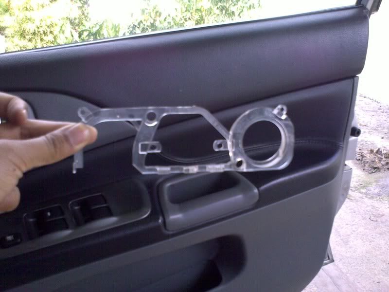

8. Remove the light tube by removing the 2 screws that hold it in place.
Do not bend or rest anything heavy on it. It seems to be an acrylic material

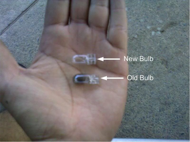

9. Remove the two blown bulbs
the stock bulbs have a blue silicon cap on them.
I believe that this is used as a filter to create white light instead of the teh incandescent yellow that is produced by the bulb
This silicon cap can be reused
TAKE OFF FROM THE OLD BULB VERY GENTLY AND WITH MUCH CARE - IT BURSTS EASILY
Old bulb and new bulb with re-used silicone cap
10. Install new bulbs with silicon caps
11. Re-install teh light tube
I didn't like the light output of these, so I replaced them with two new bulbs WITHOUT teh silicon cap
the light output is MUCH greater without teh silicon cap
12. Re-install the Demister, A/C and Recirc switch panel
13. Re-install the Audio headunit
14. Re-install the finisher

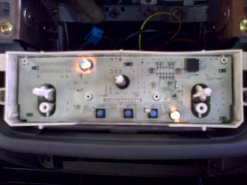

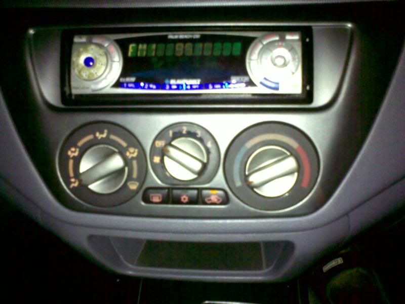

15. Observe the faint orange glow when the lights arr turned on in bright light
16. Observe the cool orange colour when the lights are turned in the dark
CENTER CONSOLE

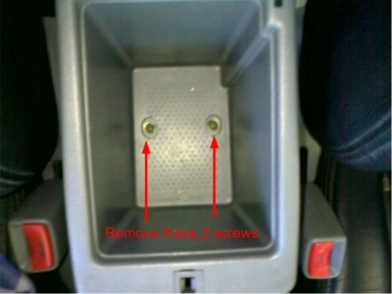

1. Remove the two screws fastening the center storage compartment to the floor of teh car, located inside the center storage compartment (between the front seats) and remove center console by lifting outwards in a 90 degree motion
2. Un-clip the electrical connector at the base of the gear lever finisher
3. Unscrew the two screws at the base of the gear lever finisher
4. Un-clip the clips fastening the center console under the dashboard (by driver and passenger footwell respectively)
5. Remove the center console
6. Remove the bulb that illuminates the gear lever selections
7. Remove bulb
8. Change bulb (same size as a press-in park light\ID light)

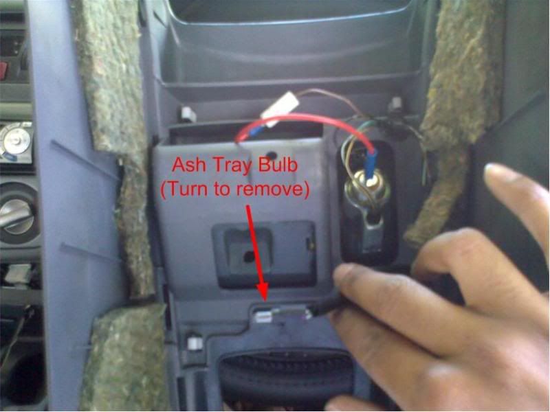

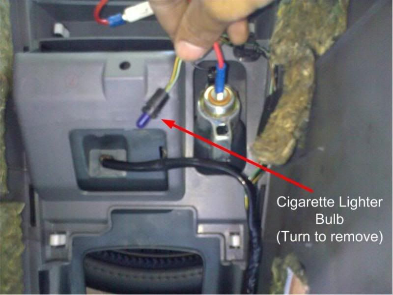

9. Locate the Cigarette lighter illumination and ash tray bulbs on the underside of the Center Console
10. Remove the ash tray bulb and replace with new bulb
11. Remove the Cigarette lighter illumination bulb and replace with new bulb
12. Reinstall Center Console
13. Re-connect electrical connector at base of Gear Lever finisher
Observe that the Cigarette lighter illumination and ash tray bulbs light when turned on
14. Reinstall center storage compartment
That's it
A/C control bulbs bought at Marud's Auto Supplies, Union Road Marabella TT$2.00 Each
Press-in park light\ID Bulb bought at Rodney's Auto Supplies, St. Clement's Junction TT$3.00 Each

Excellent DIY there thats exactly how i replaced my ac bulbs, i deciced not to use the silicone scalp too. I couldnt use it anyway cause it had burned onto the bulb.
You have a typo though, this:
Bulb #1 & #2 provide teh background illumination for all the controls, while Bulb #2 provides illumination for teh Demister, A/C and Recirc switches
Should be this:
Bulb #1 & #2 provide teh background illumination for all the controls, while Bulb #2 also provides illumination for teh Demister, A/C and Recirc switches
Now I just need to get my instrument cluster recalibrated and the lights behind the guages fixed.
