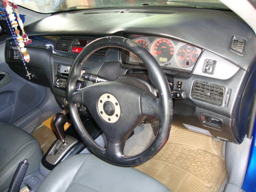

Thats mines there. I'll be running an intercooler with both side piping on one side for this tiny turbo, i noticed the original has one LONG pipe going from left to right to the intercooler.

ah like d blue trim u was talkin about...how come it didnt come with a momo steering....
TeamH2O
Posts: 8254
Re: GDi 4G93T, How To Upgrade?
Postby TeamH2O » May 20th, 2011, 2:14 pm
it says momo on the back of it lol, i dunno why, they could ah just put momo in front and done

how come your gear shift is like that? is it manual? or tiptronic? this is mines.
xtech
Posts: 3003
Postby xtech » May 23rd, 2011, 12:30 pm
raybic wrote:how come your gear shift is like that? is it manual? or tiptronic? this is mines.
because you got old model
he got new model
yes his front cut is automatic..........all gdi turbo was always mated to invecs2 4speed tranny

My front was the normal cs2/cedia shaped models, not the cs3 model ones. The guy just told me its a japanese model instead of the normal Singapore models people bring.
