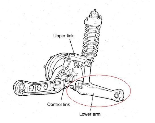

Does anyone know if there is an aftermarket equivalent to the rear lower arm from the CK2 Lancer as seen in the photo?
I know that megan racing makes the other two pieces (upper link and control link) but I can't seem to find a manufacturer that makes the lower arm.
Any help is appreciated.

The mitsubishi OEM part numbers for these are MB809230 (left) and MB809231 (right) Cost about $700 each. Never seen any aftermarket brand offered for these.
If you are going to use the Megan Racing rear toe and camber arms, just be sure to use a liberal amount of antisieze on the threaded adjustment, because they will seize after a year of use.
